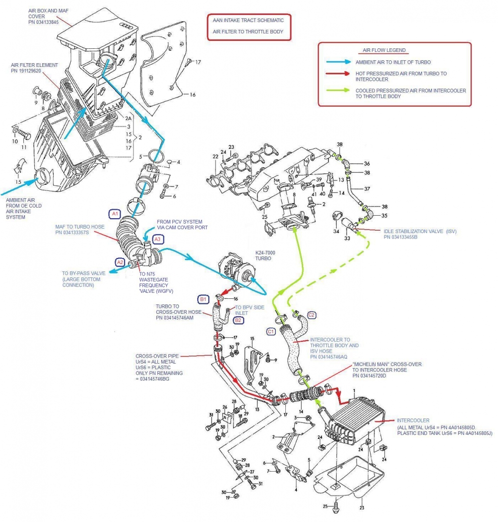

          Well in this case, no pressure. It is a BOOST pressure test, not a vacuum test.
          Read this again, I am pretty sure it says pressurize the system to about 15 psig (1 Bar(ish)) for the test.
          Yes it does: "Testing for boost leaks involves introducing controlled pressure, i.e. 10 to 15 psi from an air compressor into a non-running engine, with a pressure testing bung, such as shown in the diagram below and various other hoses plugged off (as appropriate to that test). "

              Ok, assuming a boost leak for a min, can you use an ABY boost test kit on an AAN? And cross-check with Bilko, that was an ABY kit you had wasn't it?
              Thanks all
              Rob
              Yes Rob i have the loan of an Aby kit.

                  Originally posted by UrS4boy
                  Which should work on an AAN as well.
                  Wasn't sure if the middle size bung would fit the I/c to throttle body hose as it's wider on the throttle body end compared to the Aby hose.

                    #24
                    You do not need to block off the throttle body!
                    That's a horrible idea, because 99% of boost leaks are from the vacuums and other systems connected to the inlet manifold. I don't even know who ever came up with blocking the throttle body, but they should be shot.
                    I have received a numerous amount of cars for mapping where the owner claims it's leak leak free by plugging the throttle body and in fact it won't hold any pressure from the inlet manifold.
                    All you need is:
                    * Remove MAF, plug it with a bung that has a tire nipple in it.
                    * Remove the PCV hose from the MAF to Turbo hose and block it on the MAF-Turbo hose end, leave the other end be.
                    That's it. Do NOT plug anything else, as else you will not find leaks.

                      Absolutely true abou those vacuum lines.
                      I'm now replacing all the little hoses connected to the rear of the IM since they are all gone hard and perished. Also that one way valve towards aircon recirc and diff/lock should be checked and can cause boost loss.

                        Dmitri, didn't you also block the hose to the waste gate when you did my car.
                        Or was that just for your special customers
                        • prj
                          • Mar 2010
                          • 6308
                          #27
                          Good point Lou.
                          You can block the hose to the wastegate, so that it does not hiss.
                          A minute amount of air will otherwise escape through the wastegate to the exhaust and cause a slight hissing sound. All stock wastegates hiss, otherwise they would seize when they heat up.
                          This is optional though, as it makes very little difference to the speed of the boost escaping, just it is nice to have it quiet if you are listening for audible leaks.
                            All you need is:
                            Thanks for that info that's maybe why i can't find the leak on my car still.
                              #29
                              You do not need to block off the throttle body!That's a horrible idea, because 99% of boost leaks are from the vacuums and other systems connected to the inlet manifold. I don't even know who ever came up with blocking the throttle body, but they should be shot.
                              Bit harsh?
                              Blocking off the throttle body and ISV inlet hose play out in only 2 of the 6 options I put forward for consideration as boost testing OPTIONS (Options 3 and 6). The different options allow for the isolation of areas of potential leaks, including NOT pressurizing the PCV system backwards.
                                You do not need to isolate anything. All this is under pressure each and every time you are under boost. So it only makes sense to pressurize everything.
                                The PCV system never gets pressurized this way. Ever. If everything you put in leaks out of the PCV then you know the one way valve under the manifold is shot.
