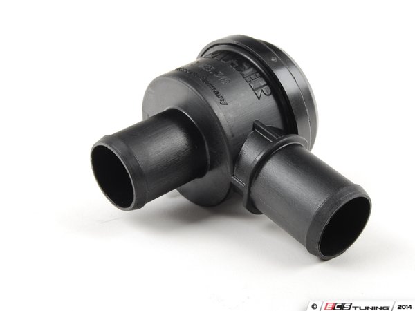

    I have been suffering a running issue with my S2 for some time now and have been slowly narrowing down the problem. Having replaced the plugs, new lambda sensor, new coil pack conversion courtesy of error 404 (brilliant OEM looking harness thanks!), and new red Beru coilpacks. I was still getting this strange surging at about 2000-3000 rpm. On full boost no problem. Had double checked all boost hoses (silicon) and clamps. Today I decided to remove the Bosch DV valve. I tested it by pressing down on the valve with a 8mm socket and1/4 extension and then placing my thumb over the small nipple valve and removed the socket. The valve returned straight away. So decided to take it apart to examine the rubber diaphragm. This is what I discovered.
    I presume this is the cause of my running issue. Any advice would be much appreciated.

    The 710N (06A145710N ) is still available through the dealer and aftermarket systems. It's just that Bosch sold the rights off to a third party, Kayser, who is now making them.
    http://www.ecstuning.com/Search/SiteSearch/06A145710N/

            If you can buy a used Bosch 710N, they are very robust and apparently the Kayser ones are poor quality

              Will try TPS Monday. Have been told that Bosch DV 06A145710N has now been superseded by 06A145710P. Is this correct?
