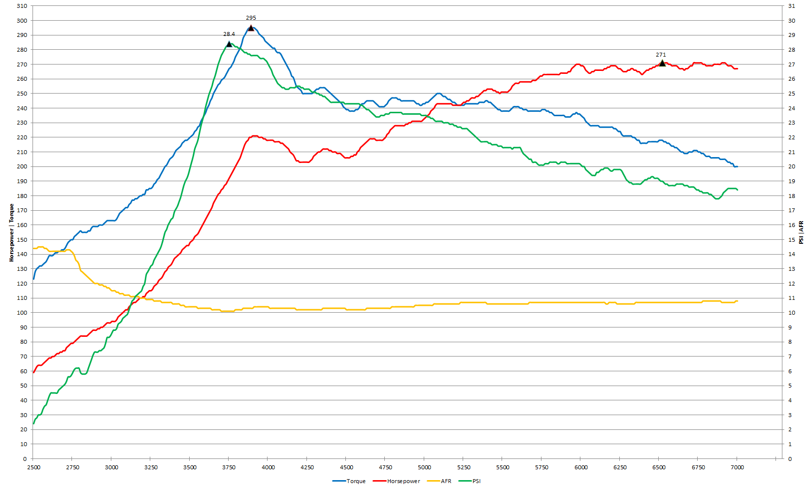

Yeh, mines dipping to 10.8 or so on WOT so obviously not a fuel trim issue it would seem. Still edging for a hiding boost leak maybe!?Leave a comment:

As for your question, my off the top answer was going to be an AFR of around 11. Here are some UrS AAN dyno results that back that up:
