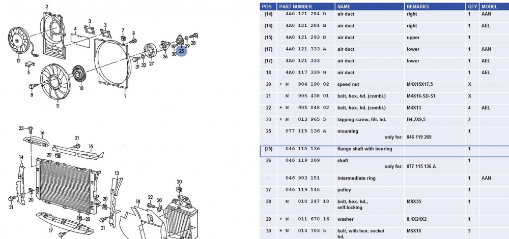

    Hi guys. As per title, bearing on viscous fan isn't in a great shape so I'd like to change that. I can only find bearing with a bracket, but I assume that bearing can be pressed out and replaced, without buying the bracket?
    Anyone know sizes or PN for that bearing?

    Hi guys. As per title, bearing on viscous fan isn't in a great shape so I'd like to change that. I can only find bearing with a bracket, but I assume that bearing can be pressed out and replaced, without buying the bracket? Anyone know sizes or PN for that bearing?
    You wish. I think you can get the bearing (and housing) separately from the shaft but don't quote me:
    The old style bearing (Item 25 = PN 077115136A ) (on the left) and shaft (Item 26)(on the right) look like this:
    The first Item 25 is the bearing assembly which goes with the Item 26 Flange shaft. The second Item 25 (highlighted by the box) is the bearing and the shaft as one unit.
