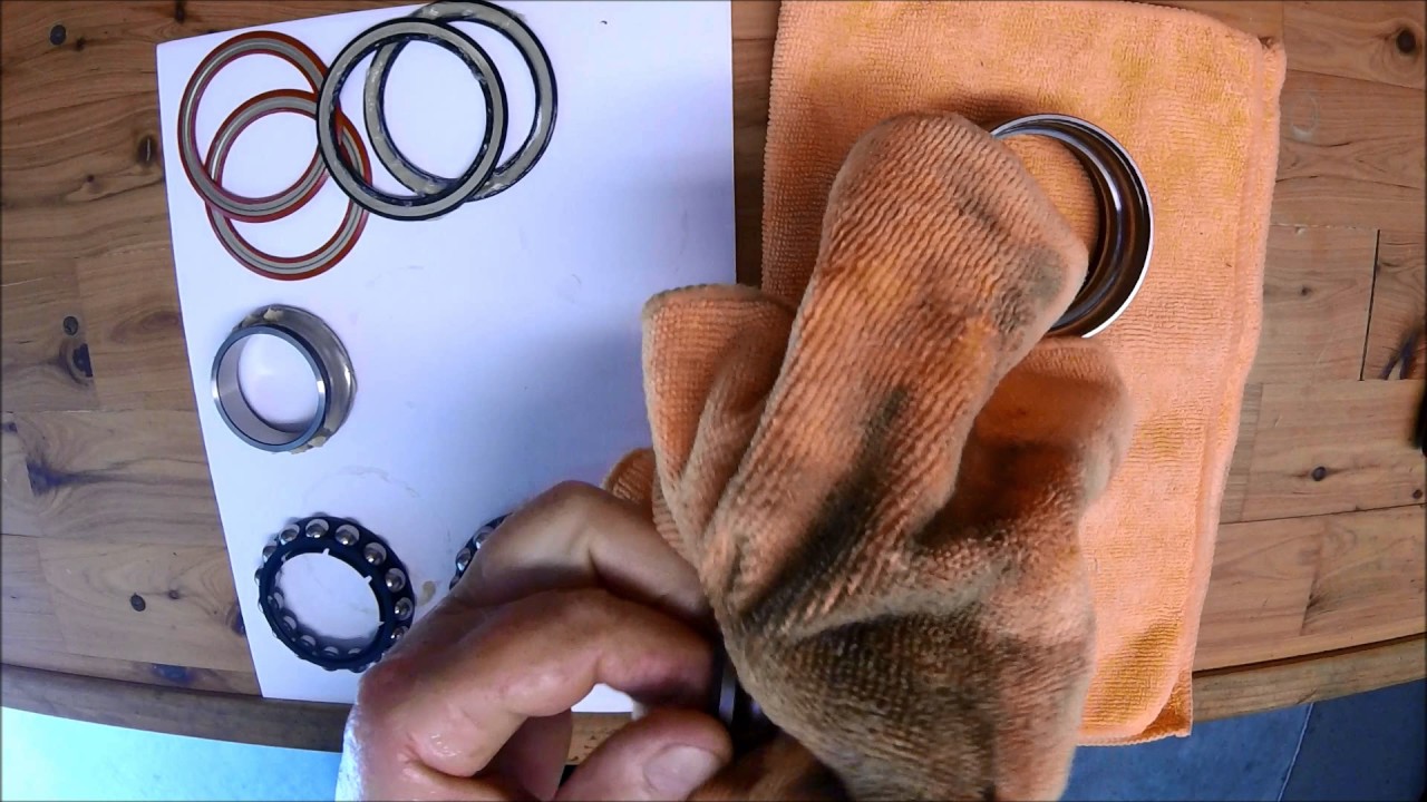

                          Just to make a note.
                          Recently, it has been find that FAG bearings may not be all they used to be. This company found that FAG bearings were not lasting on the Spec Boxster race cars they servcie. So they started taking them apart and repacking them. You will notice when they take the bearing apart, that is sorely lacking in grease.
                          They can have my car when they pry my cold dead fingers from the steering wheel.
