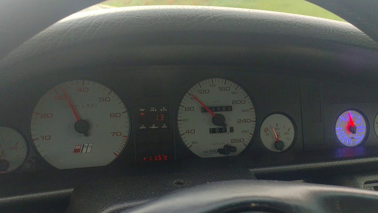

                      #25
                      100-200 in 4th gear in around 10 secondes:
                      Stock K24-7000
                      Stock cats
                      034 2.2b wastegate spring
                      630CC Siemens injectors
                      320L/H AEM Fuel Pump
                      Running 100% E85
                      Not bad for an almost stock-ish car
                        • 4754
                        #26
                        Do you know the 0-60mph (96.5 kmh) figure?
                        • Sava
                          • Oct 2017
                          • 15
                          • Country: France
                          #27
                          No i don't, i never launch it
                          The only Time i've take was 140-200 in 5 gear (6 seconds) and this one 100-200 in 4th (~10s)
