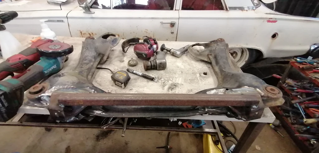

    I made the new rear subframe from a good front one. Added brackets from old junk rear sf and got anti roll bar brackets at same time. Rear control arms were also rusted through, found better ones from parts piles.

    Some nice rusty pictures of rear subrame and control arms
