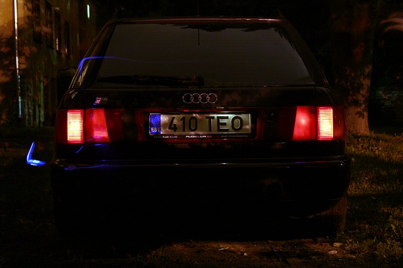

                  I wonder if the light mod will work on urS4/S6 (c4) ?

                    Originally posted by AudiRS
                    Yes, you can. I actually came up with this idea for my earlier B4 Sedan, the mod counts for the Avant too.
                    I had a plan to use the sidemost blanks on the hatch as taillights along with the normal wing ones and just mod the rear fogs for extra set of brakelights. Ofcourse getting the lamp socket into them in the first place would be challenging.
                    Had a thought of doing that on my UrS6, but they would just look wrong because the inner side is tilted, would not have this kind of problem on S2 Avant/Limo though...
                    And to take this a bit further, why not use all 3 lamps per light as taillight, and keep foglight+normal brakelight for brakelights. Should be dead easy on Coupe. 5W/21W bulb and few diodes to keep foglight/brakelight/taillight functioning as normal.
                    Logic behind this for me is to get extra set of brakelights. The originals without 3rd light are hard to notice on a quick glance, but add in some low flying winter sun and bad weather - I dont want anyone to plough into me when they dismiss my brakelights as normal taillights.
                    Not the best picture in the world, but you get the idea:
                    On an unrelated note, the left numberplate light seems to be broken for nealry 6 months now (at least), and I noticed that only a week ago
