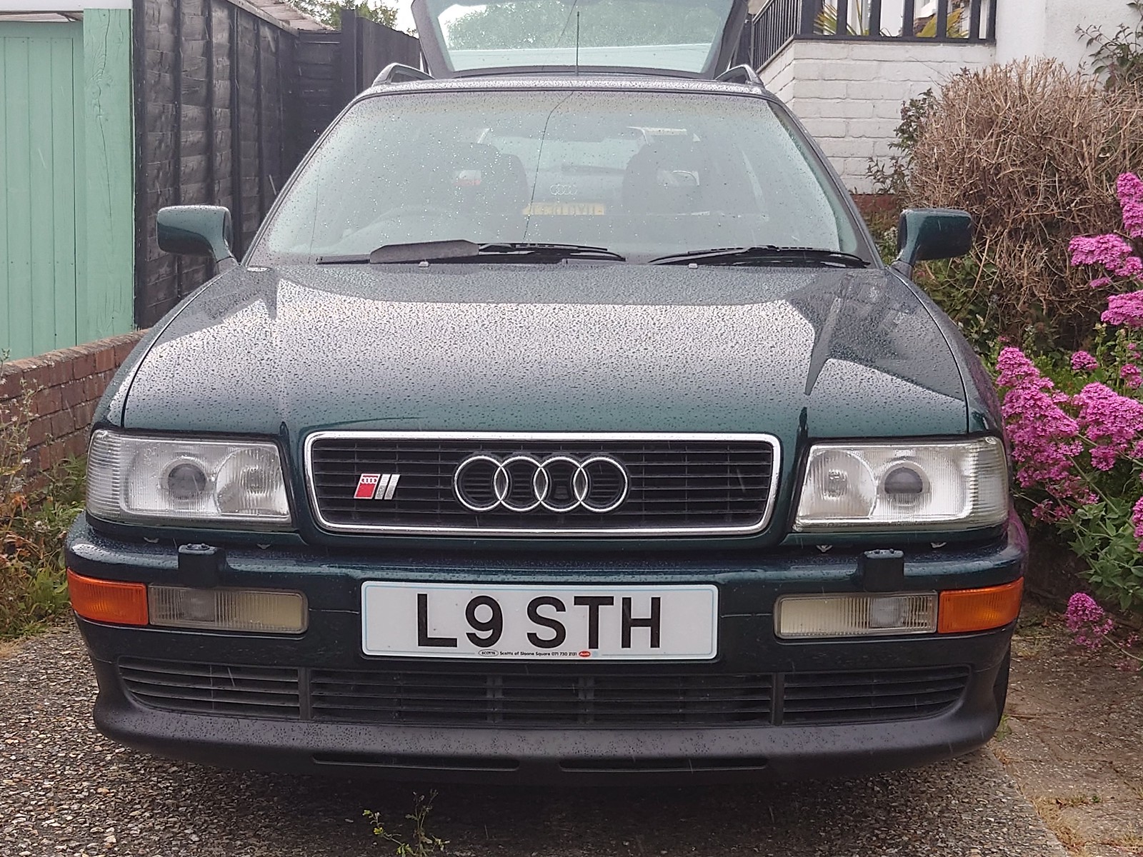

  • Ian Simmonds
    replied
    The elipsoid redemption…
    Before I even start this post, I’ve got to give a huge thanks to John (newsh) who gave up a couple of hours to pore over schematics and listen to me trying to fry the car.
    This started way back when, when Dave (tractor Dave) sold me a pair of elipsoid lamps in care worn condition. Knowing my original Hella were flaking (and getting ropey), I decided to tidy the elipsoids up and fit them.
    I started this job last summer and finished it yesterday. Tardiness and procrastination being the root cause.
    Anyway, John pm’d me the elipsoid thread and I set too.
    Fitting was easy.
    The old, nicely yellow ones
    Came off, and the shiny elipsoids went on.
    Then the fun started with the wiring. The trick here (for this car) was to swap the 2.5mm yellow wire from pin 7 to pin 8. It did take us about an hour messaging and finally a phone call to work through the options, but we got there.
    Ordered a couple of new H1’s to fit.
    Incidentally, anyone fitted LED side lights and recommend a brand? The incandescent ones in it at the moment are pitiful.
