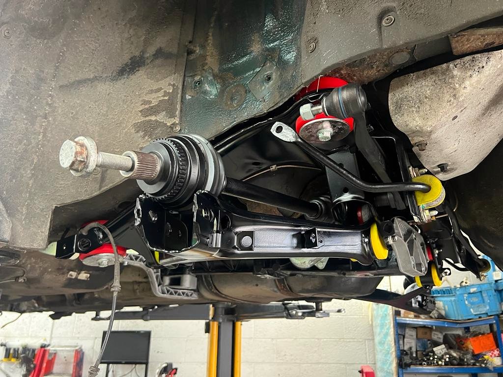

    Some more - the subframe mounting areas before a tidy up.
    And rear subframe and drive going back in.

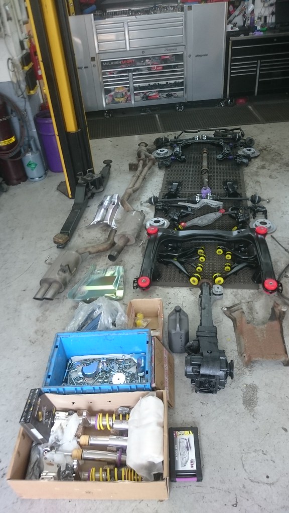

    Bit of an update….
    The underside is empty now.
    An organised pile of parts for refurbishment
    The subframes coming off
    After 29 years the subframes were a bit crusty but solid and refurbish-able.
    Hubs and diff brace ready for refurbishment.
    And after….
    The rear diff was sent away and refurbished.
    As were the alloys.
    And the driveshafts fully rebuilt.
    Everything else including the subframes, wishbones, heat shields and fixings are due back from the metal refinishing next week and hopefully it’ll all start to go back together.

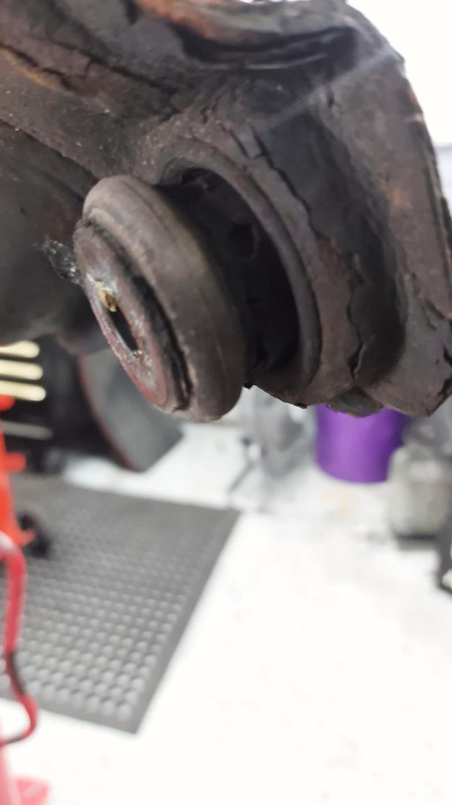

    A couple of winters ago I tore the driver side door seal one frozen morning. Afterwards, if I parked the car at a certain angle, in a certain spot and with the appropriate West Sussex storm force southwesterly, it’d leak. So, I inserted some additional wadding (screen wash tubing) to bolster it up and then glued it/ Vaselined it (ooo-err-Mrs) up. This worked but it wasn’t pretty. So, Tractor Dave recently managed to rustle up an excellent condition replacement which I collected the other week.
    Every time I take any trim off this car I’m absolutely gobsmacked as to its excellent condition. Audi really knew how to build proper automotive tanks back in the mid-1990’s.
    When you bear in mind this (photo below) is under the seal that hasn’t been exposed to daylight since new, so 28-odd years and has never to my knowledge been garaged. That ain’t bad.
    New seal on and good for another 28-years.
