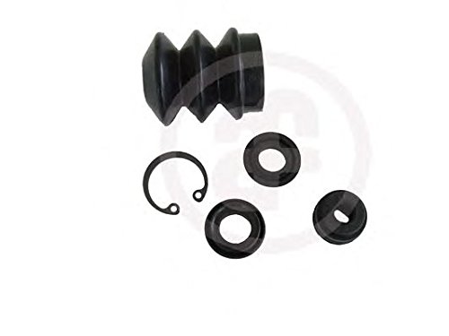

          Did some repairs on the master clutch cylinder few days ago, it was leaking. Strapped a repair kit on it and all is good.

              Any PNs to share on the clutch master cylinder rebuild kit?

                No upgrades while the engine has not been rebuilt I'm afraid... And I'm still undecided which turbo to opt for.
                Sure Dave, it's an Autofren Seinsa D1-447

                    Thanks for the PN. Found a few sources on eBay/Amazon, etc.
