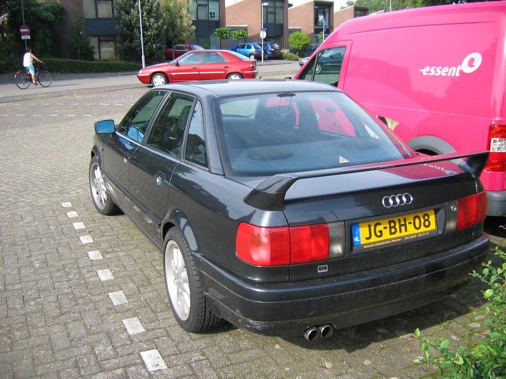

      Hey David,
      We're going to leave it off for now, yes. This is how it looked before we started:
      About the springs, we've bought a kit (this one but for S2) from larkspeed, they found out the best fit. We had to modify the pipes in which the absorbers fall (don't know their English names) since they came from the coupe donor, but it's all nicely finished.
      About the rear brakes, they are V8 calipers (these ones) with 310mm ventilated and drilled disks, and modified RS4 ehm, what do you call them, holders? Handbrake cables are V8 ones I think, we've just measured and picked some out of a magazine full of audi parts.
