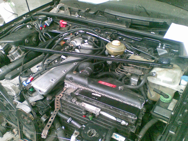

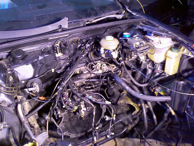

                    Haha lol, sorry I don't come here so often. Today we took the compy for a drive but it was (don't know the english word... Like there's marbles rolling in the engine when you're underneath 2000 rpm) quite hard so decided to go for a software remap and not drive it untill then, to avoid detonation damage. We used the 3b power steering pump and we also switched the brake cylinder from the s2 and removed the original drum. You can see it (badly) on the pictures. We also used the 3b brake accumulator ball ('bomb').
                    Before the software remap, we want the airflow to be better. Because the small ori 3b IC is not cooling that well, we want to install the big IC we allready have. But to do that we'd better also install a short intake manifold because the inlet is at the other side, and that's quite hard to find out because we want to keep the original radiator in place. And so it goes on...
                    And yes it had airconditioning but we removed that. We're doubting wether or not to try to fix it but it's quite hard because the lines won't fit anymore and the pump has to be fixed to the engine etc.
