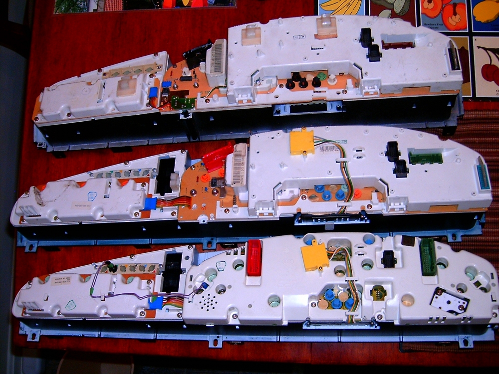

                  #758
                  Originally posted by Dift
                  I'm looking for a nice OEM boost guage install, but not sure where to place it. 2bar standard on the dash read out is interesting, with MTM mine readys upto 2.4, so glad to know it's doing something.
                  FYI: As soon as you change the MAP sensor in the ECU from 250 kPa to 300 kPa, the calibration of the in-dash OE digital "boost" gauge (actually more correctly an "Absolute Pressure in the intake manifold" gauge) is fubar'd. Useless other than a vague sense that you are making boost (over 1.01 kPa atmospheric absolute pressure).
                  I like my boost gauge (relative boost, with vacuum) location (see below). If replacing the clock with a boost gauge was easy, many many UrS owners would have done this ages ago. Truth is I know of one or two that have done it. Problem is those three gauges (including the clock) are NOT indiviual gauges. They are three faceplates that attach to a single printed circuit board. Replacing anyone of them with anything, e.g. clock for boost gauge, requires major circuit board surgery and wiring.

                              It's a good idea. Just very likely beyond your skill level. In almost 17 years of UrS ownership and UrS forums, I have only seen 2 boost gauges installed where the clock was. Nobody ever shared how exactly then did it either. (Nice, thanks guys).
                              To do it, you'd have to a) figure everything out about Item 16, printed circuit board and b) the re-engineer connections/wiring to individual gauges. Maybe you could do it. But even then, the location is NOT optimal for checking while driving. A-pillar or steering column pod would be better. I mocked up something for the top of the dash but didn't get any support/demand so I dropped it. (I am more than happy with my A-pillar gauge pod)(See below)
                              Back side of Audi 200, UrS4 and UrS6 clusters:
