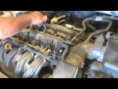

      https://youtu.be/5i39i-PyQxA
      Watching this makes me realise that it's just a conrods bearing failure. So hopefully we will be ok.
