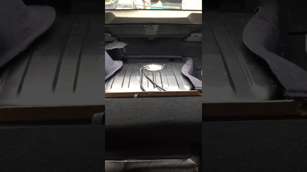

    So I really hate my S2 at the moment,to the point I’m thinking to sell it
    I have fitted new pump and basically straight away I have got the same problem.i have fitted all covers on the top of the tank,carpet,parcel shelf and started the bloody thing.Lovely and quiet.So took it 3miles away to petrol station and on the way there I noticed it’s starting to run slightly louder then few minutes earlier.It goes completely silent on hard braking.

    im still going with strainer and pump location.
    test 1 loosen cap on filler and try it.
    test2
    try this with the old one or new one. get a pipe on it fill a coke bottle with fuel. link pipe to bottle and pipe on outlet to another bottle or bucket. use 2 wires from a battery. see what sound you get. or use a bucket of fuel and put pump in it and pump to another bucket. see if it sounds ok. this will ensure the check valve/outlet is not an issue too.
    mine is outside the car and only sounds like that when
    1. tank was blocked and strugglnmig to get fuel out
    2. fuel very low in tank and gravity issues.
    3. new gravity feed from new tank to pump too long so not best flow.
    we call it a scavenging sound. like the pump is struggling to pick up fuel. fyi my s2 was very quiet when the metal cover went back on. barely audiable.

                      id say its not quite right too. it sounds like its starved or getting air in. mine under car is not that loud. with the covers on like you have mine in the s2 was basically silent.
                      is it relayed. on the s2 mine wasn't but is on the saloon.
                      is go for pickup but maybe rule out the check valve. i have no experience of issues here so not sure of the sound. i have years of experience with starved 044's with the lines and the tank issues on the saloon. it sounds like this
