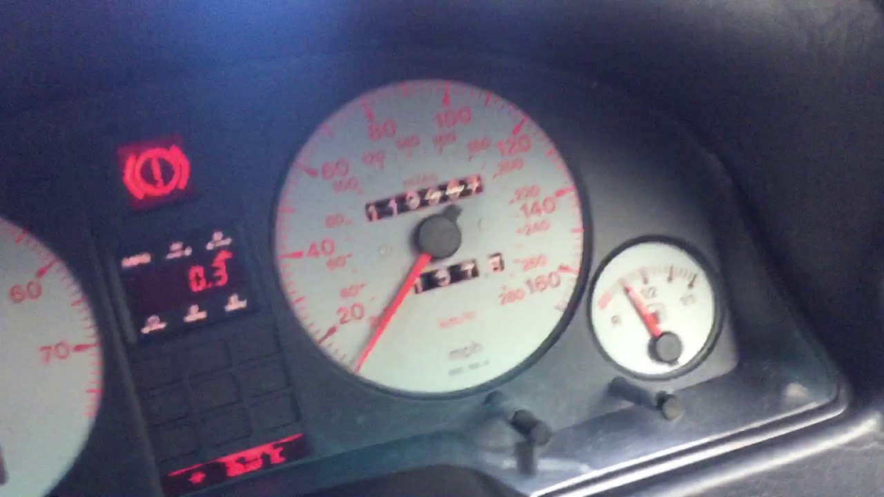

                      I did have a few minutes of free time today and I took my S2 for little spin.I still hate the 044 pump but I love the car,With low boost setting it’s still lighting up all 4 tyres as in the video

                        What video?

                            I’m trying
                              #29
                              you are a criminal

                                Hahaha- it’s only 1.1 Bar Boost set up.I have got Turbosmart gauge and 4 port solenoid waiting to be installed etc etc.But even now it’s still such a weapon.I think I really upset owner of audi S6 and M3V8.THANKS TO AUTOMARK
