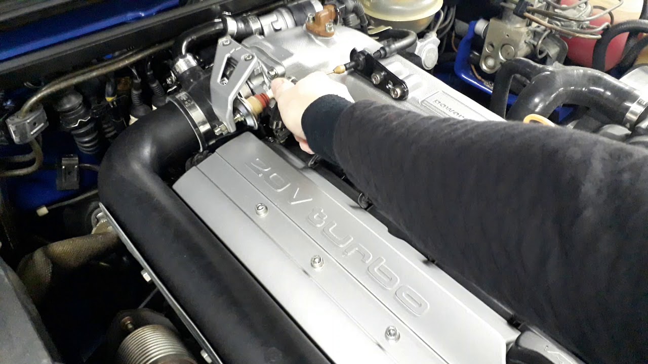

Ok, if i'm thinking about the same hoses i think they only can be connected one way if you use the original stuff. You mean the connections on the right on my picture?
45764-9344e4816193fef29549cd35c3672019.jpgComment
Yes, looks like you’re rightComment
