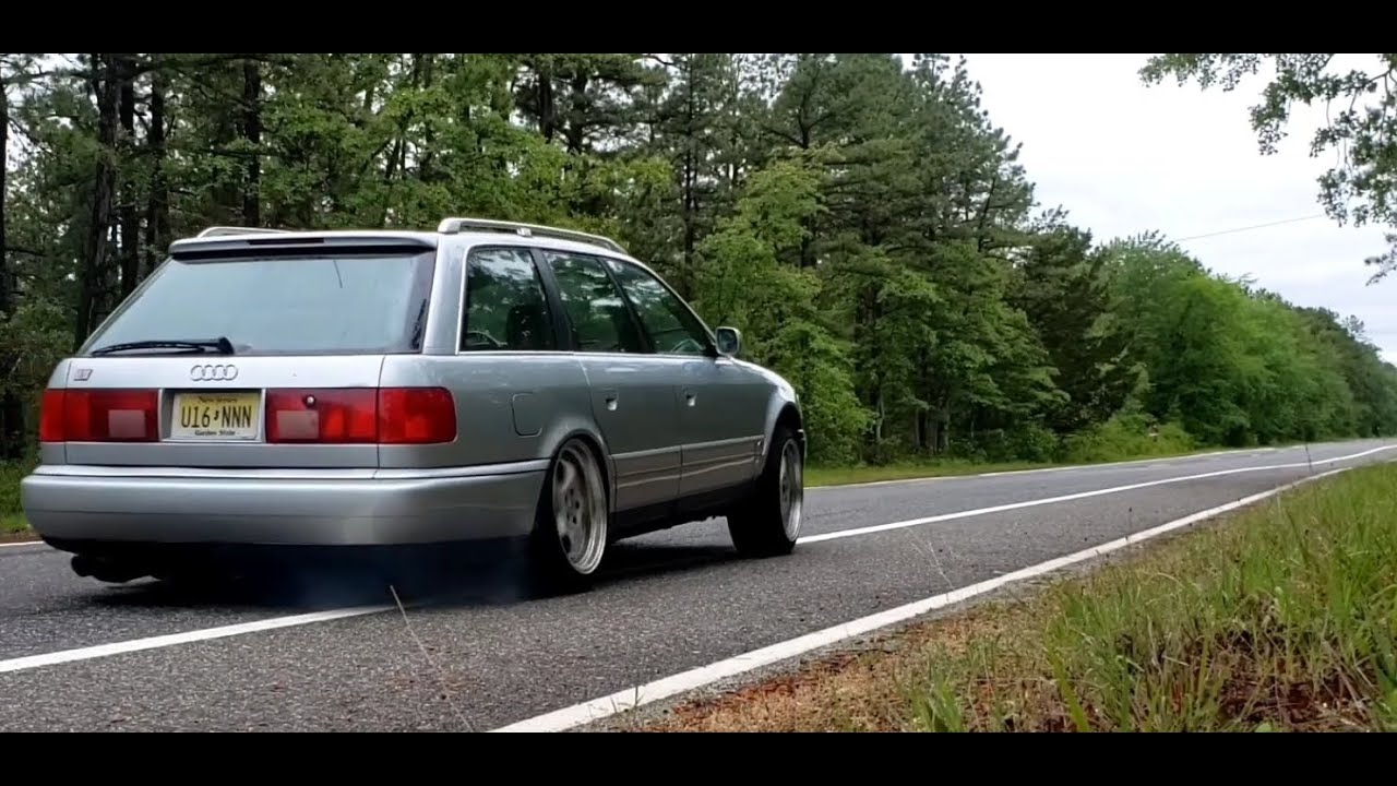

    V8 (32V) barely fits because of the cooling pipes in front of the engine. V10 is 1,5cyl longer (cylinders are bit offset), then there's stuff in front of it and then try to close the bonnet. I'd say it's no go.
    It does fit in C4 tho
    https://www.youtube.com/watch?v=81tt4fSiMac

          Hey guys, don't mean to bring this back up from the dead, but I was curious as well and found my way over here...
          Haha, it doesn't fit in a 4000q so I don't think it'll fit in a B3 either. I took measurements on the Coupe to see if it'd fit in a mid engine conversion, but the front crank pulley would sit right at the base of the driverseat (using a Porsche Boxster 01e and). I will say... its beautiful in a C4. Tuning is done and she's a ripper. Let's get some more 5.2 swaps going!
