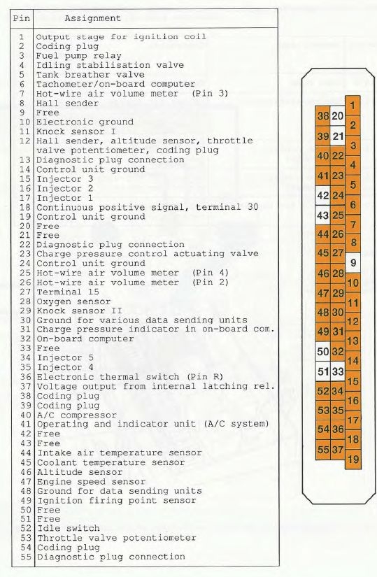

                        Too bad about no AutoClimate control. All I can offer now is this link to MFTS info, including pin-outs and PNs for replacement plugs and a 3B pin-out (I think the MFTS signal is pin no. 36 because 45 is the G62). Reading either would likely require a VAG-com connected to the diagnostic ports in the fuse box.
