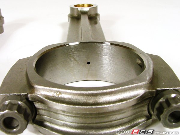

            You do mean a hole like this?

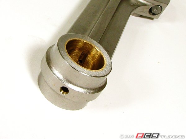

                    Nice cross sectional shot here:
