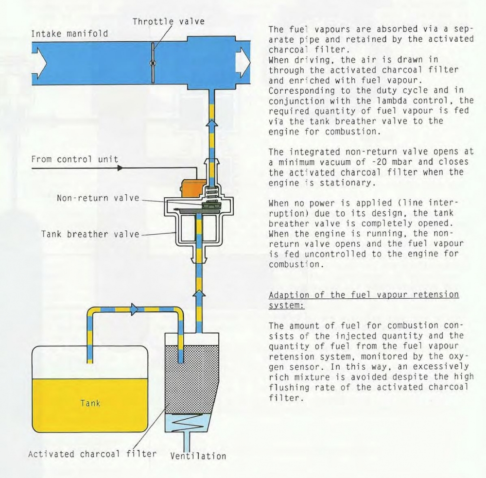

After commenting on Rocco thread on reliability I think an aftermarket accessory failed.
I drove 60km without issues. At one point the car started getting too rich 0.75lambda on idle rich.
I stopped the car and noticed that the tank cap was overflowing. Pulled the injector connectors and still the engine stated and idled. I then hit the injectors and it stopped running. Connected them and did 3-4 kms. Everything was fine. After that it was again too rich.
Lambda and EGO behavior seemed fine.
