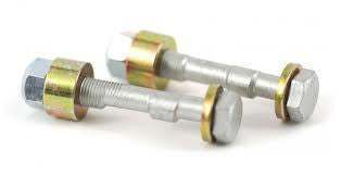

          I'd like to add that H&R makes some nifty camber bolts for the strut uprights.
          Could be a nice solution without having to sacrifice NVH using billet top mounts. Or combine both for that maximum attack on a track beast.
          Link:
          Consisting of a pair of specially-designed bolts, H&R patented "Triple C" Camber Adjustment Bolts replace the original upper fastening bolts on McPherson strut applications. As the bolt is turned, a small cam eccentric alters the vehicle's camber, allowing adjustments from 0-3 degrees, positive or negaTUVe. When yo
