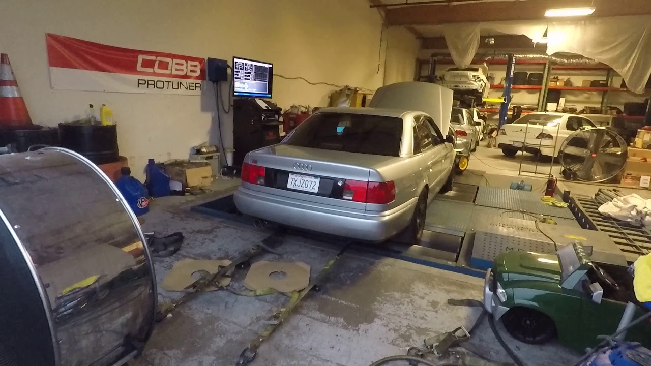

Hey all!
Wanted to share some great power numbers for the K24-7400 Volvo turbo on E85.
My setup is:
-Volvo K24-7400 with bigger billet hybrid wheel and machined k24-7000 hotside
-870CC injectors
-7A cams
-IE H-Beam rods
-Calico coated bearings rod/main
-Arp head studs
-Walbro 450, EFI relayed
-Apikol FMIC
-Wagner RS2 evo exhaust manifold
-034 phenolic intake spacer
-VEMS, speed density. Marc Swanson custom tuning.
-034 catch can kit
and more.

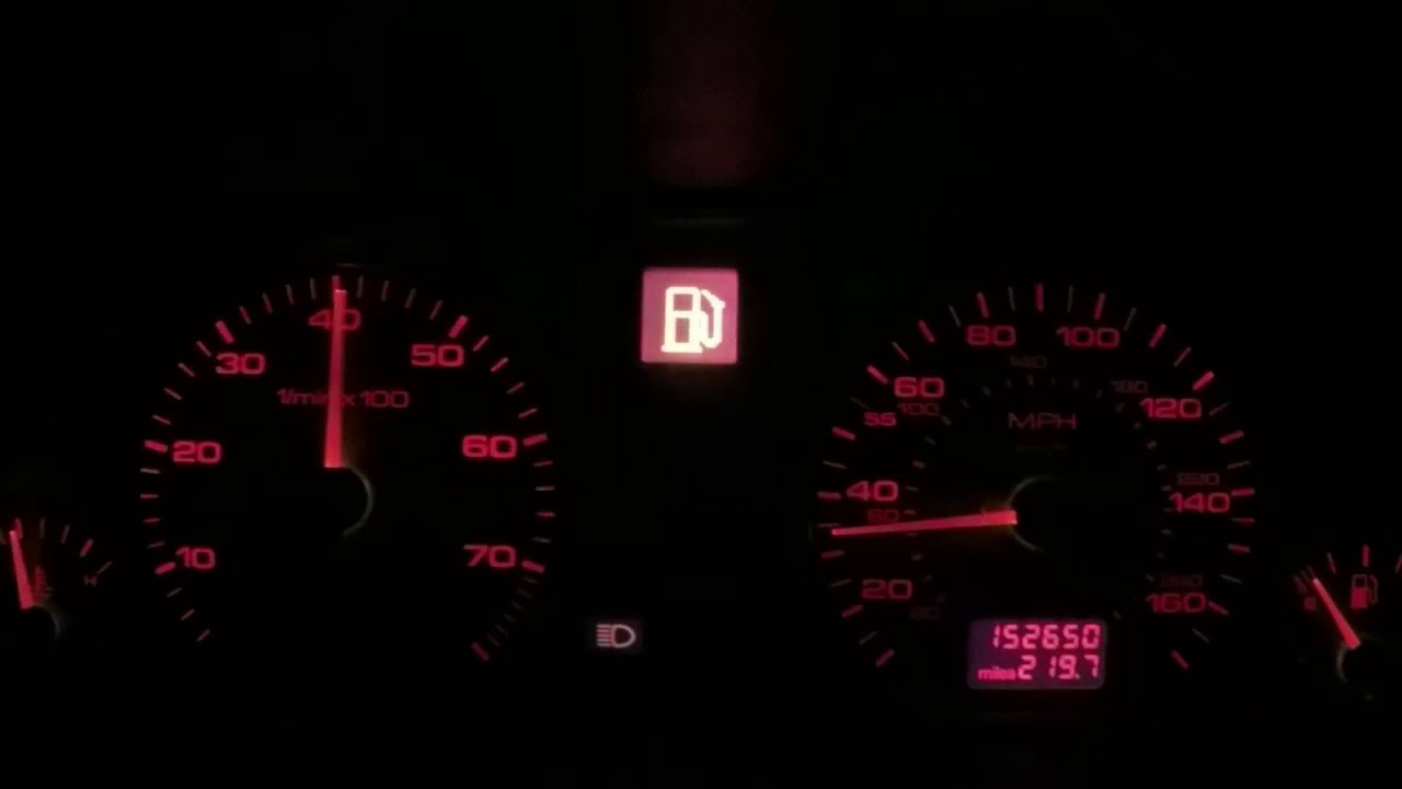

I see around 25-28psi at 3400 rpm, full boost of 35psi at 4000 rpm all the way to redline. Really happy with it for now. Just enough power for me and I wont get bored of going between 91 & E85 as I have a flex fuel sensor and I believe Marc S. tuned it so it is flexfuel capable (adding 91 to E85 gives less power, adding E85 to 91 gives more power).
Made 466whp/403wtq on mustang dyno. Trying to get to 500whp club with some intake manifold porting, ported throttle body, and head work!
Enjoy!
91 octane dyno soon to come.
