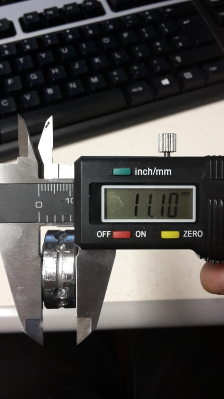

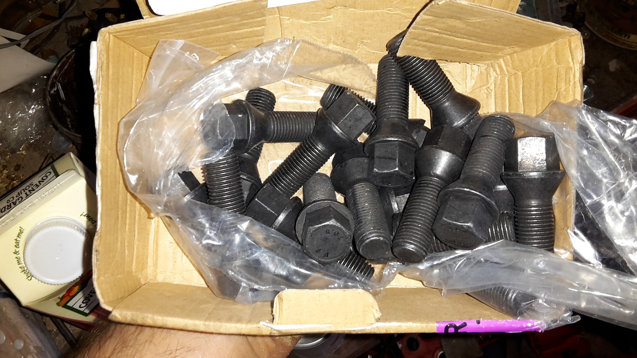

              There has been a mix match of different lengths of wheel bolt on the car since i bought it. So i treated myself some new ones:

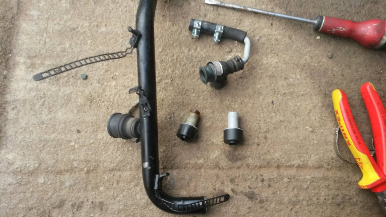

              The car had been smoking now and again even though i had changed the crank case breather. After a bit of reading it sounded like the one way valve was knackered. So i got a new one and fitted it. This has fixed the smoking problem i've been having:

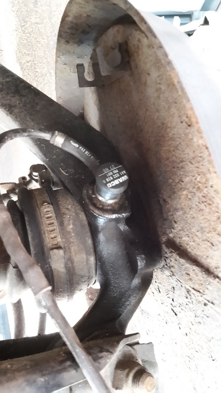

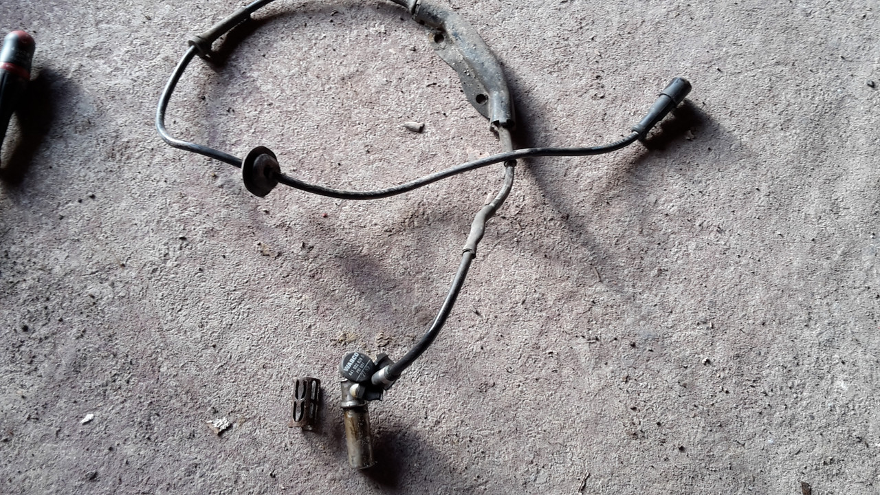

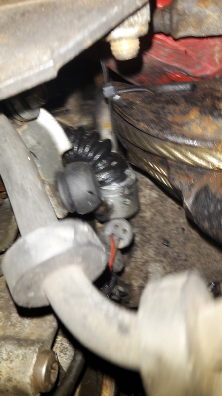

              I've had an ABS light on in the car for a while and with the MOT coming up i thought i would get it sorted. I checked the resistance on each of the sensors and the rear passanger side was faulty:
              After a bit of looking i found that sensors were very expensive and i wanted to find a cheaper solution. After a bit of help from the forum i found that an A4 sensor would fit and that i would just need to change the plug. So i ordered on of ebay:
              http://www.ebay.co.uk/itm/Delphi-Rea...UAAOSw5IJWcGyT
              The old sensor was a ****** to get out but after about half an hour i got it out:
              I then cut the plug of the old sensor and soldered it on to the new one. Once refitted this worked a treat and the ABS is now working again.

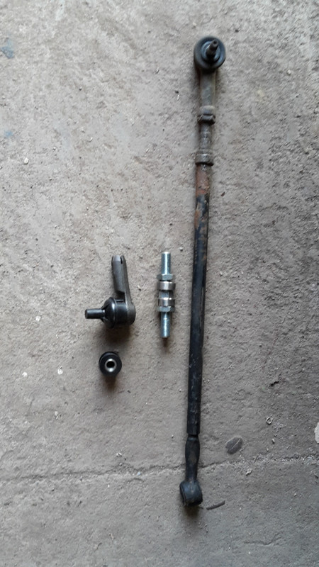

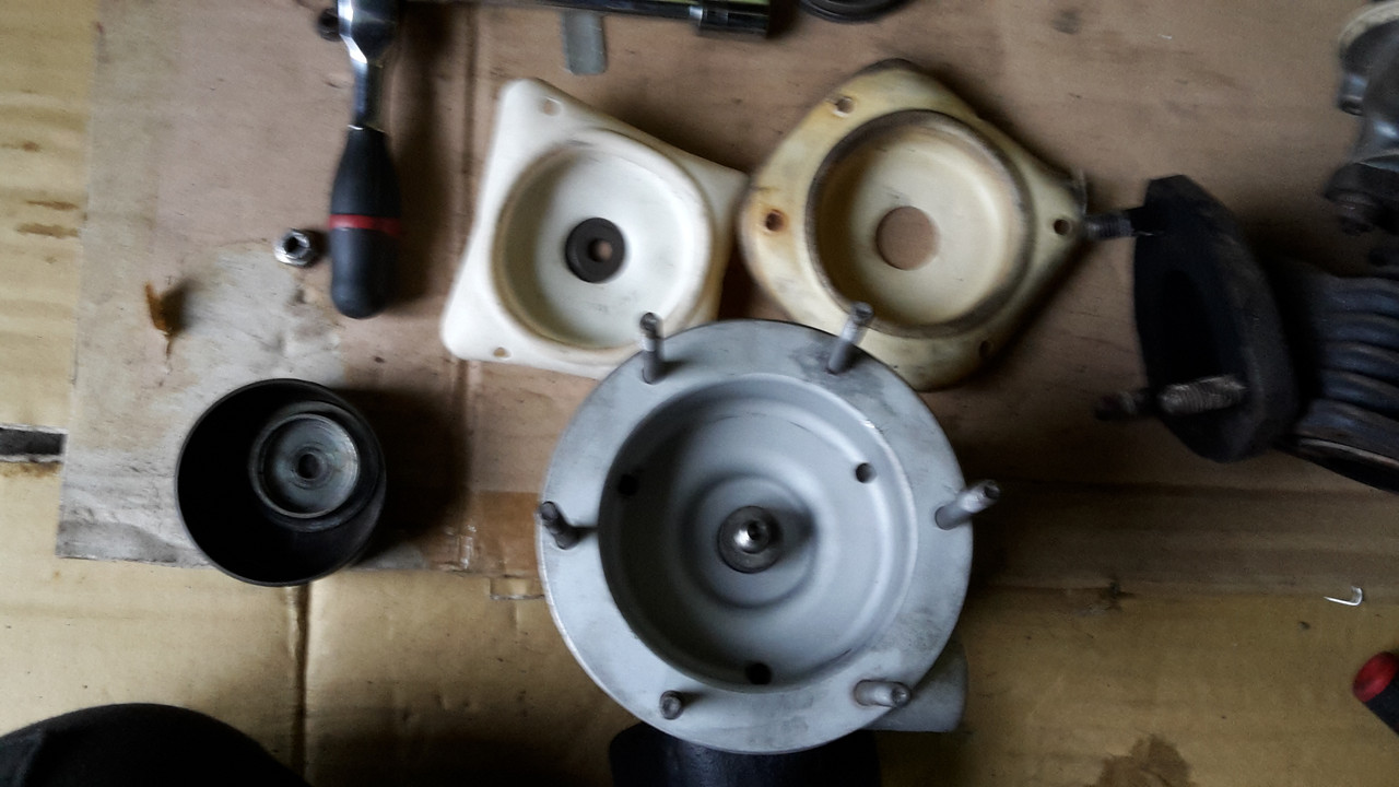

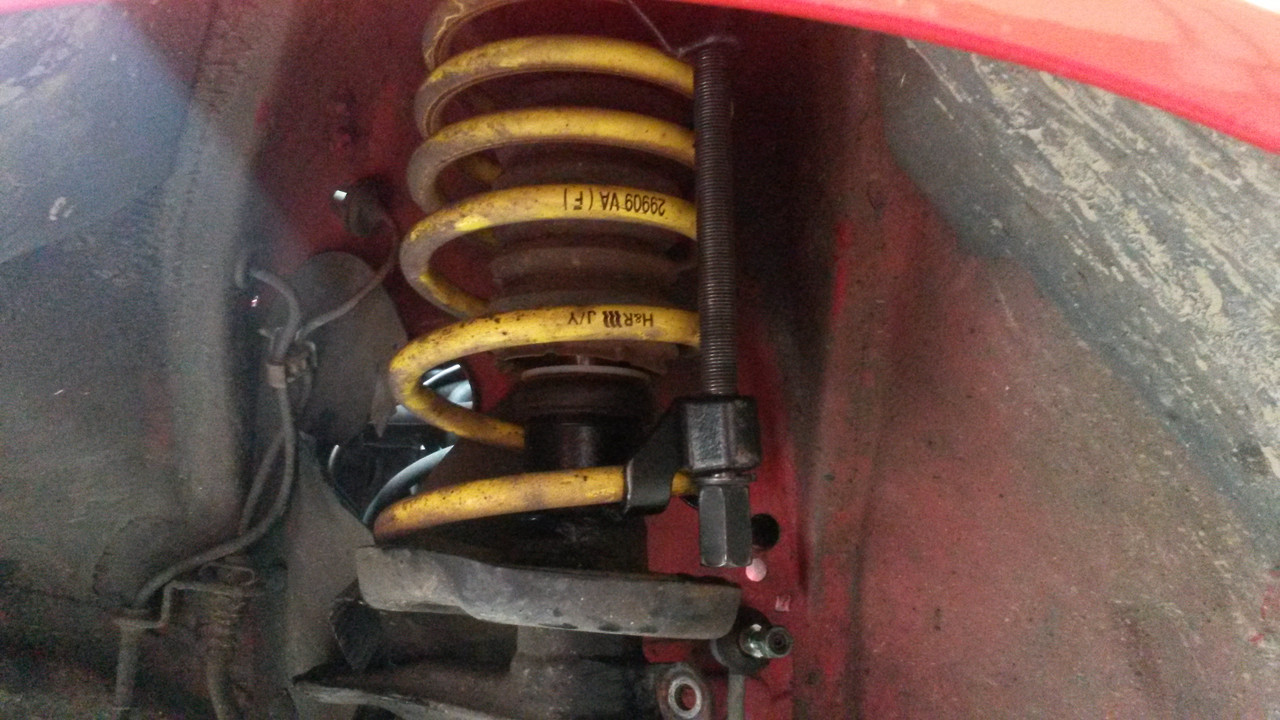

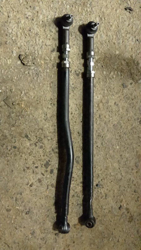

              The front passanger side spring has been upside down since i bought the car. There has been a knocking front the front which i though was the spring binding up. I decided to change the strut tops while i was at it:
              This solved my knocking problem. My track rod ends were looking tatty and the adjusters were seized solid. So i ordered some lemforder track rod ends from ECP:
              http://www.eurocarparts.com/ecp/c/Au...53beedd&000349
              i also ordered some steering arm bushes and adjusters from bambridge:
              After a bit of cleaning up and everything up:

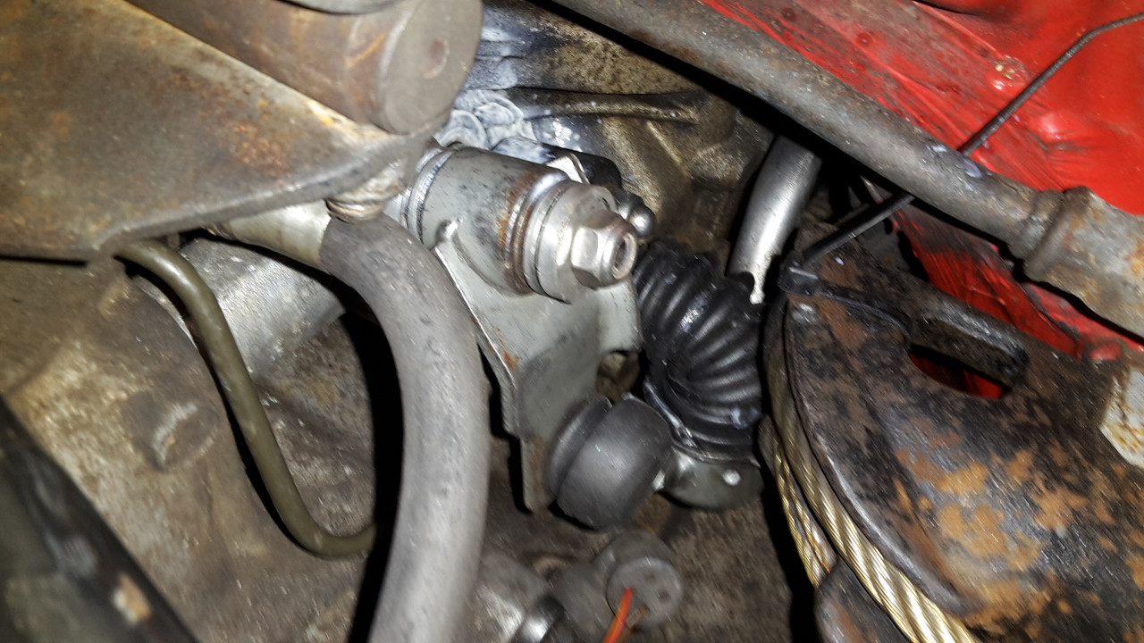

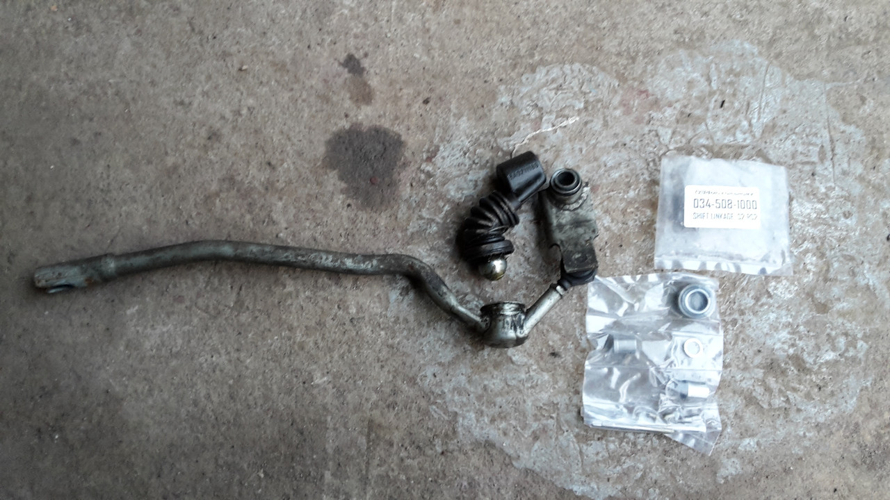

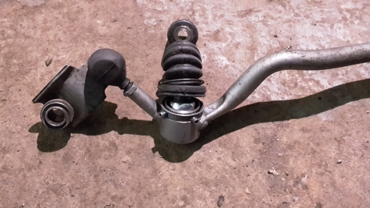

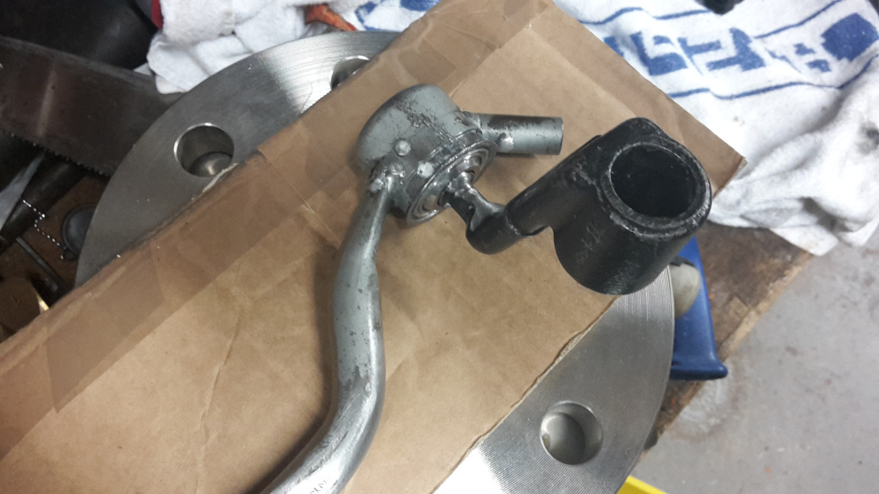

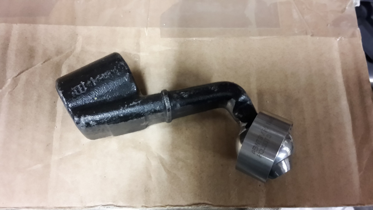

              I have been having problems with my shifter. The so i bought a 034 shifter bush and fitted it:

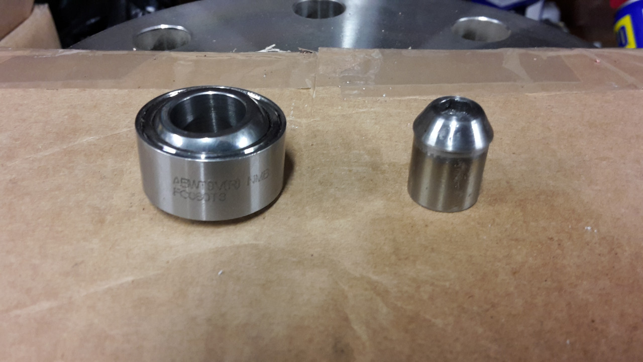

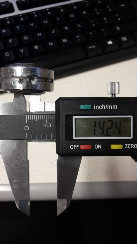

              it was a poor fit and the bearing kept coming loose. After a bit of measuring and a morning of searching online i found an alternative to the 034 bush that would fit better:

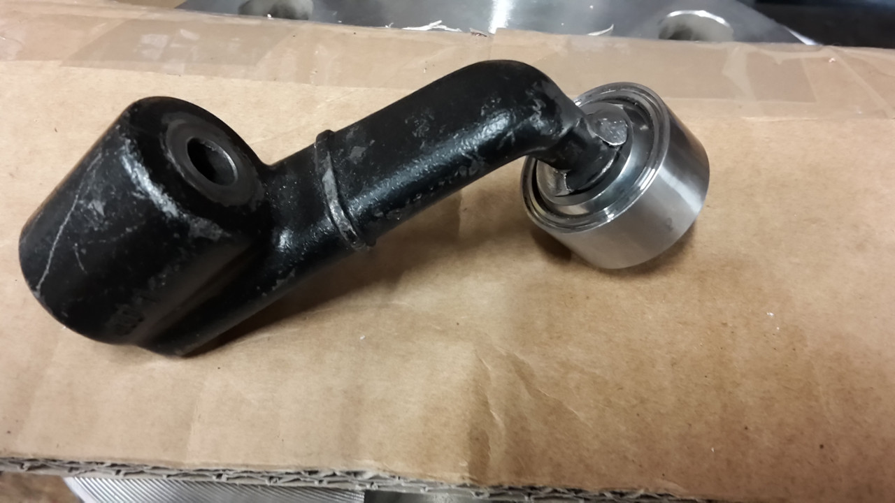

              this is the bearing i decided would fit better than the 034 bearing:
              http://www.wychbearings.co.uk/abwt9v...l_bearing.html

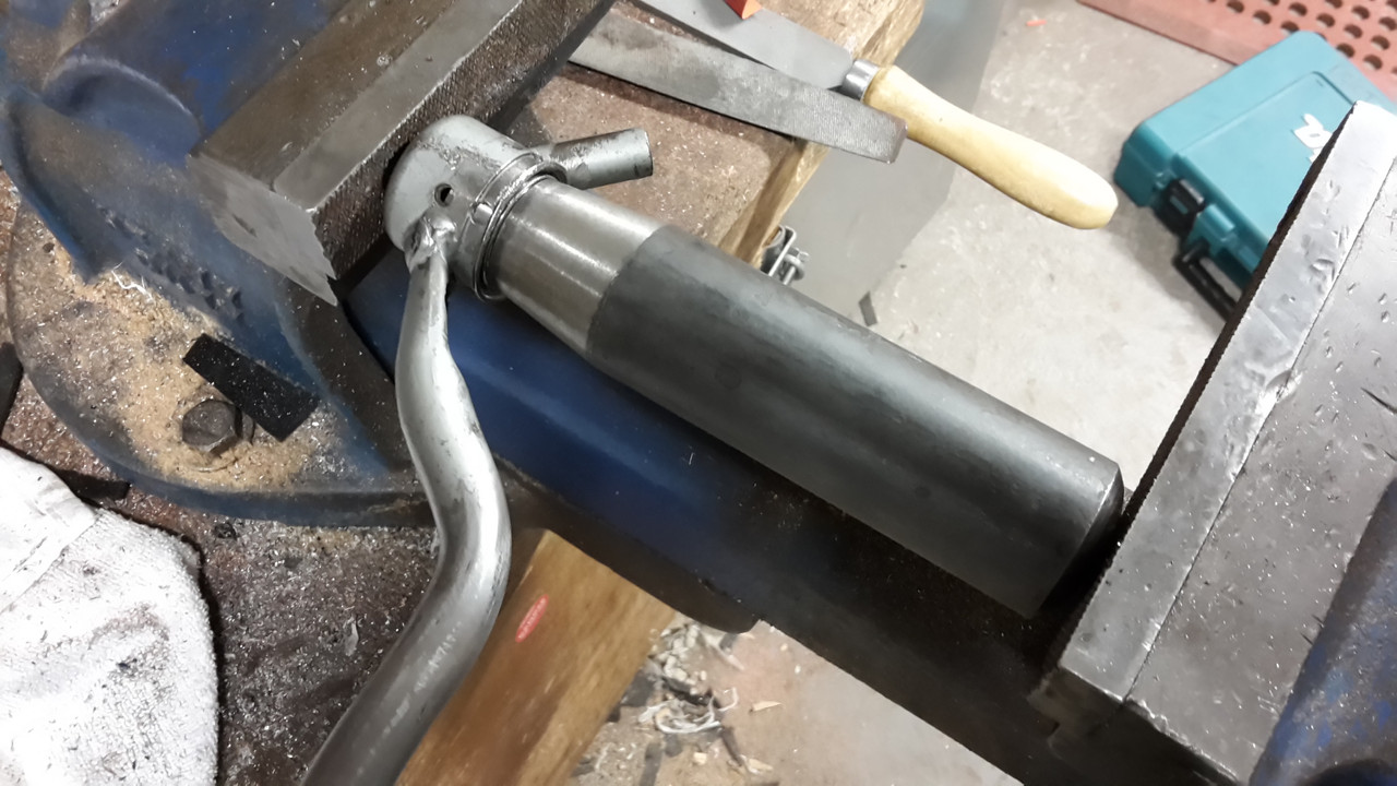

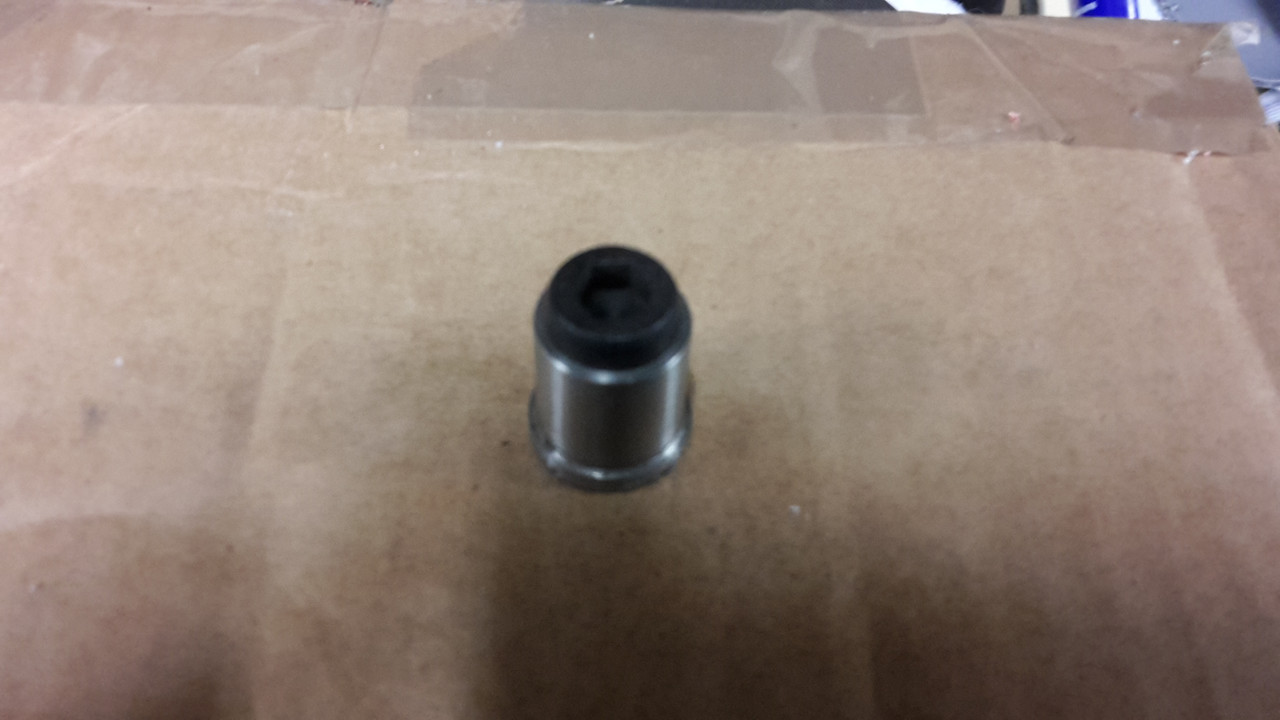

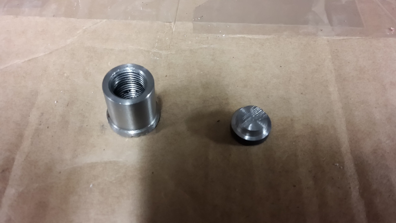

              Then knowing i would have to press the bearing in shifter arm i would have to be able to tighten the sleeve once it was fitted. So i set about modifying the 034 sleeve. I decided to use the head of an allen bolt and weld it to the sleeve:

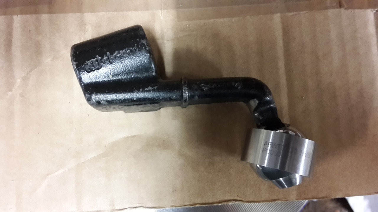

              After welding it to the sleeve i turned down to allow the bearing to have as much movement as possible:
              I then noticed that i need something to stop the bush from moving up the shaft. So i welded two tabs and filed them down to allow the bearing to clear then:
              The bearing has a larger range of movement over the 034 bearing:

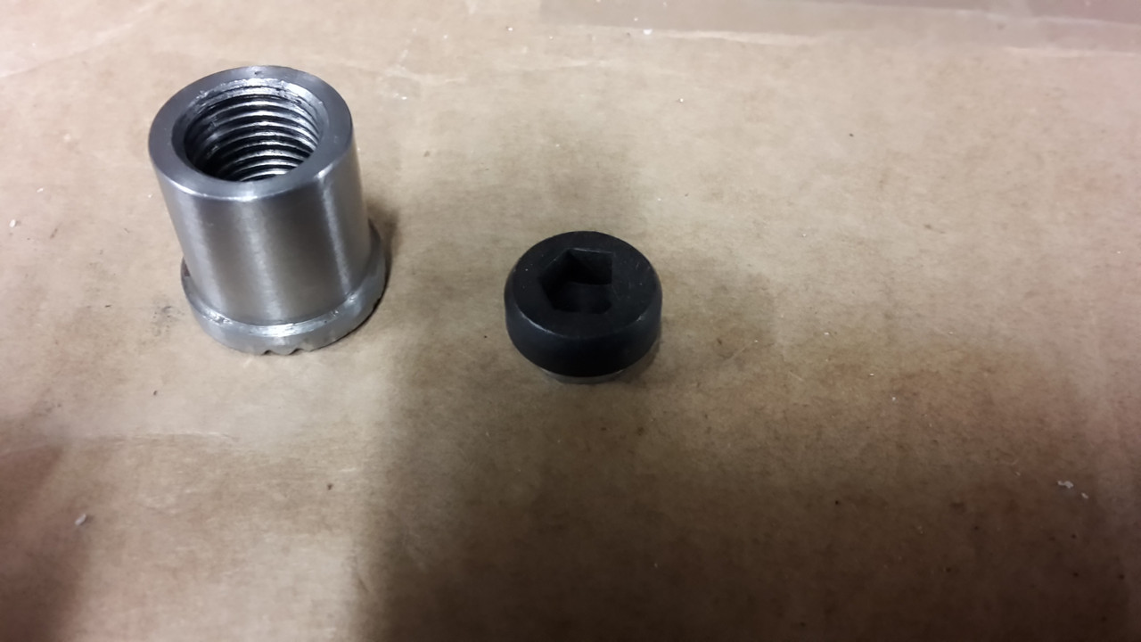

              I drilled a hole in the bottom of the shifter arm cup. This would allow me access to tighten the retaining sleeve once the bearing was pressed in. I forgot to take a photo of it. I then pressed the bearing into the shifter arm:
              The bearing is a really tight fit so won't need the grub screws to hold it in the cup. I then fitted it together:
              I then fitted it to the car:
              after about an hour of fiddling couldn't get it to to select 5th and 6th. I then realised that the front pivot arm bushes were worn and when tightened it was pulling the whole arm across to 1st and 2nd. So i made some bushes out of alloy and spaced the arm out and it works a treat:
              The bearing is stiff but i think it will loosen of the more its used. The main thing is it selects all the gears.

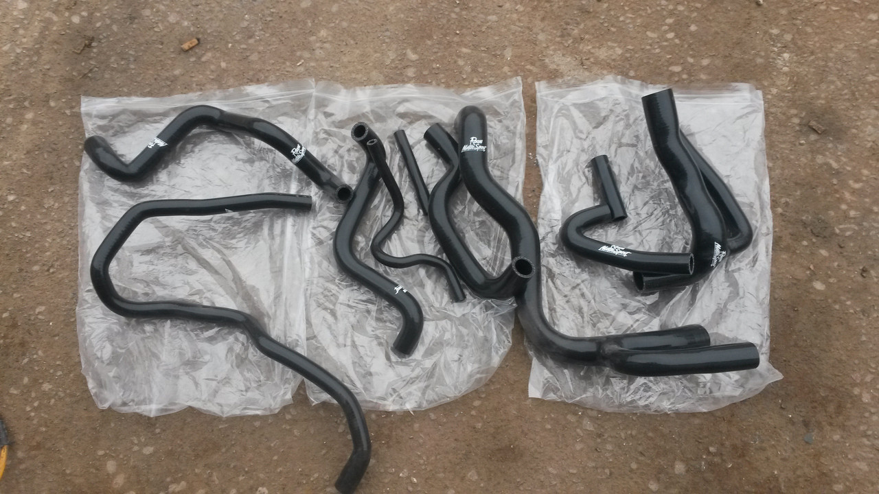

              I kept having coolant hoses bursting. So i ordered some roose coolant hoses:

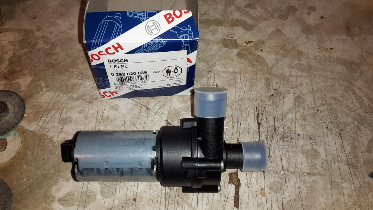

              While fitting the hoses the top snapped of the auxiliary pump. After a bit of hunting i found a pump:
              http://www.ebay.co.uk/itm/BOSCH-WATE...IAAOSwKIpWAb4t
              The pump arrived and i got it fitted:

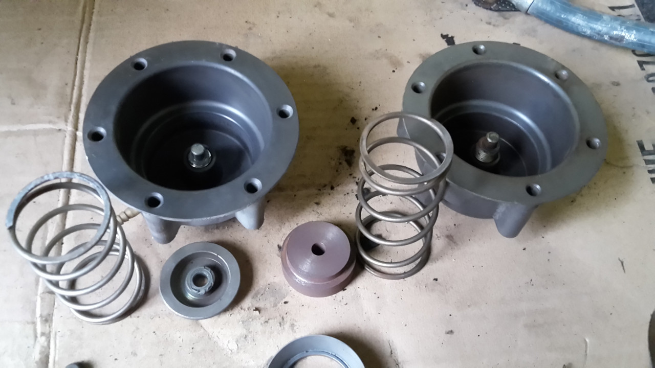

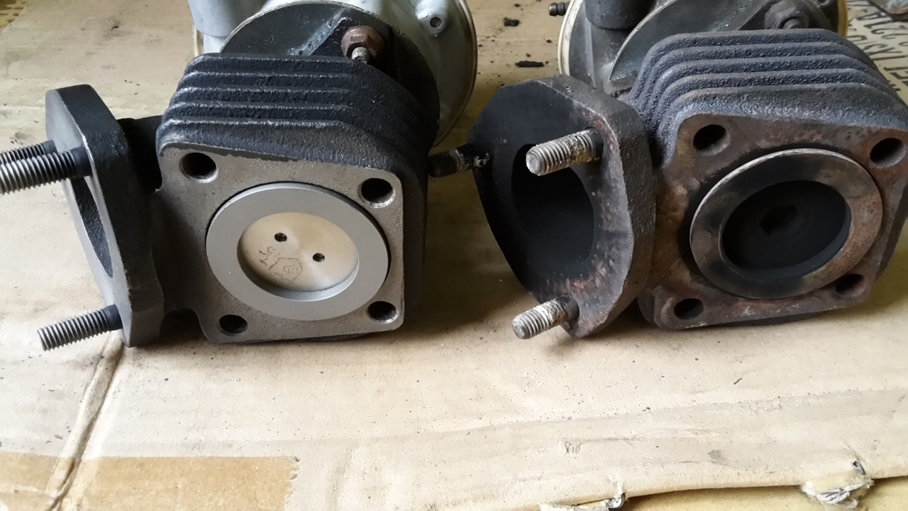

              The only thing i had to do is change the wastgate diaphragm:

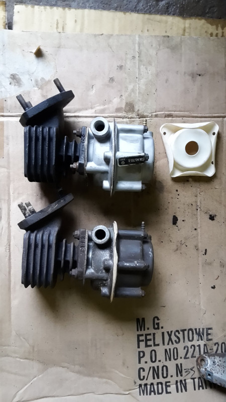

              When i stripped my wastegate (right hand in photo) i found a spacer and the adjuster screw had been turned right down:
              My car has a homefries chip. Is this spacer and adjuster screw fully out normal to have or has someone been messing about with the car?
              I fitted the new wastegate without the spacer.

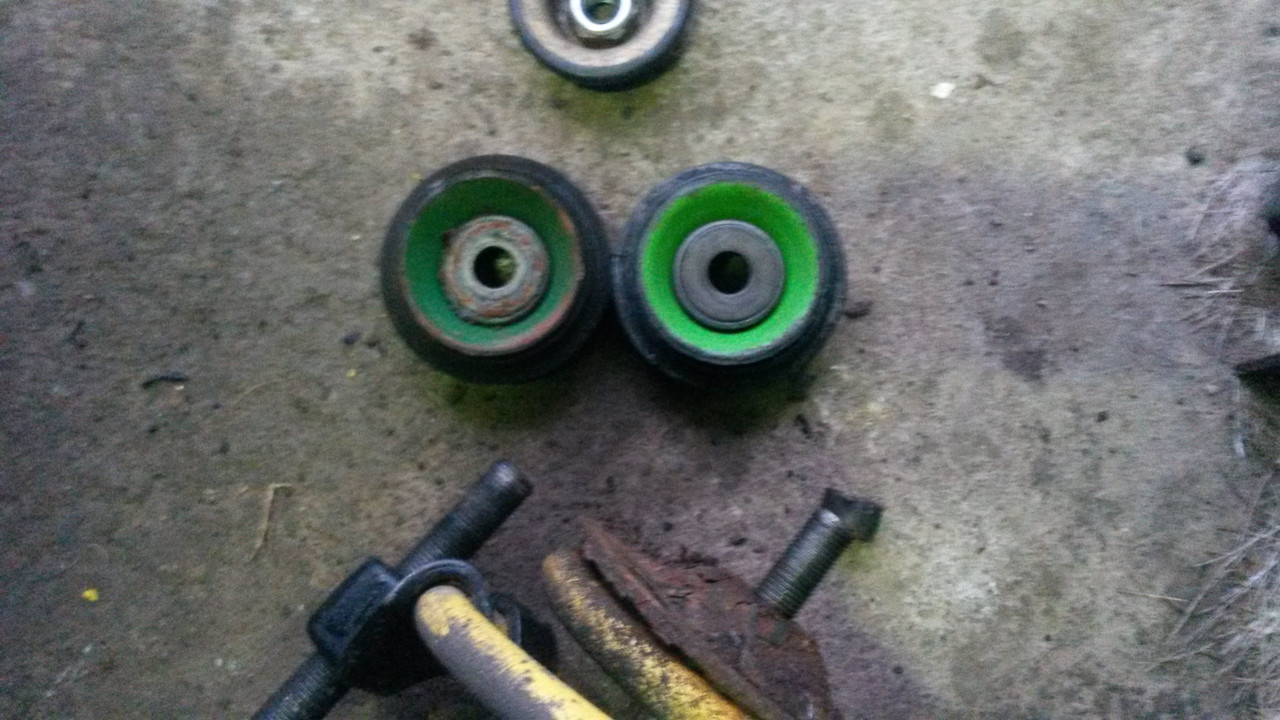

              I fitted a poly stub mount bush:

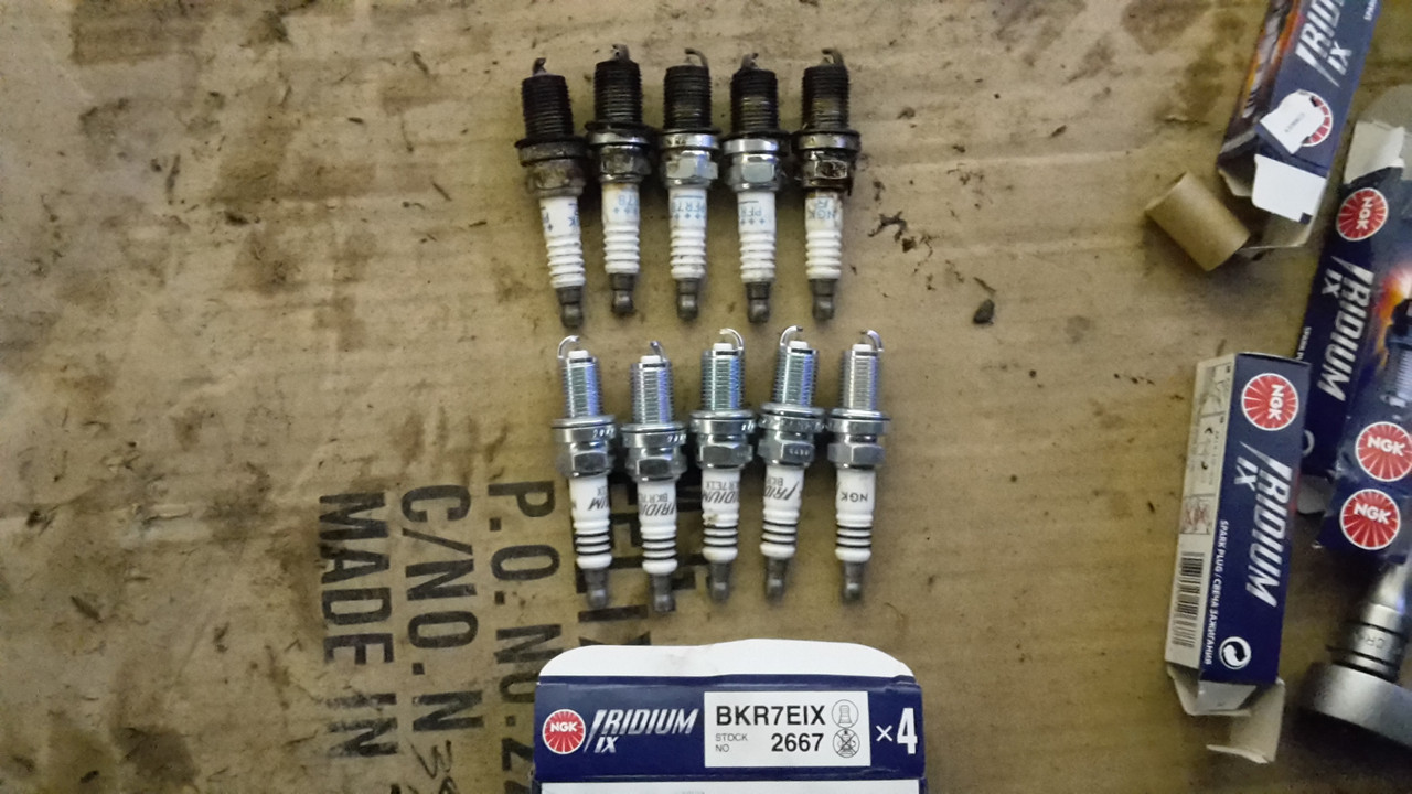

              I decided to change the plugs while working on the car:

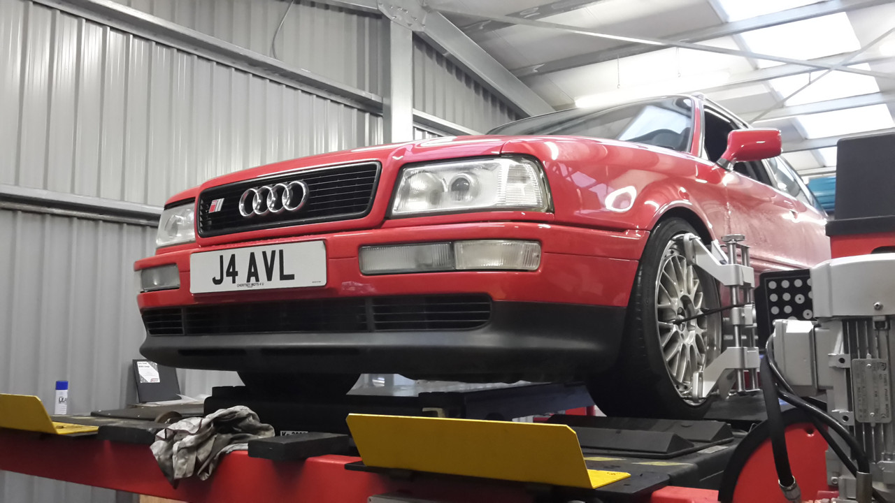

              I then got the car MOT'ed which it passed no problem. With having the front apart and rebuild the steering arm to bits the handling was all over the shop. So i booked the car in to get the geometry set up:
              Even though i tried to get everything close after the rebuild the geometry was out by quite a bit. The car is now driving great again.

                      The snub mount has a lot less play in it. I'm in the process of making a mount with a cup on it. This should have no play in it.
