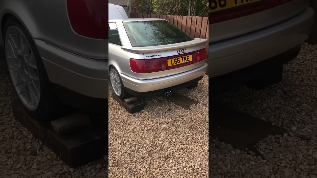

    Exhaust nearly done, just a bit of tweeking on the hangers to get it sitting a bit better. Not sure I would attempt exhaust work again, enjoyed the welding but hated everything else!!
    As the exhausts done I could finally get coolant back in it so can actually run it for a decent amount of time, got the timing properly set. Above 1500 it revs for fun but it's struggling below and can't get an idle at all. Really struggling with the settings of the ecu, don't understand a lot of it and scared to mess about too much so think I'll make sure it's oil and water tight then get it down south for a proper set up and mapping.
    • That sounds nice already, going to be epic i'd imagine when fully sorted. Would be great to see this car out on a tour at some point?
      Exhaust looks great!
      • Thank you, I'm looking forward to the day I'm actually in a position to be able to consider taking her to shows and on tours!!
        I feel like I'm reasonably close to finishing it but I'm not quite sure if that's actually the reality, still got a lot of smaller bits to button up but from experience they can take up as much time as the larger bits.

              • That sounding like the Jaguar XK-F and that is one crisp sounding v8 you never tire of hearing. Great stuff!
