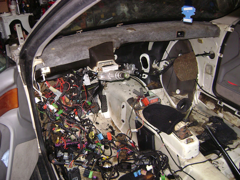

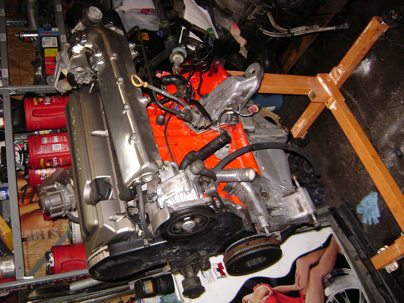

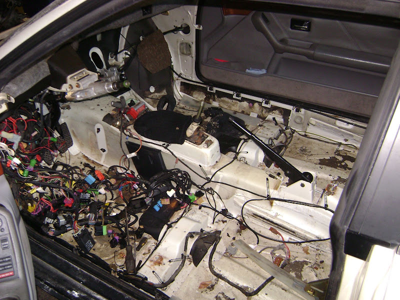

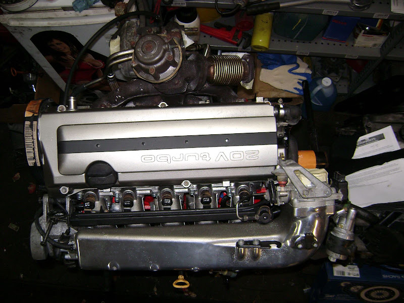

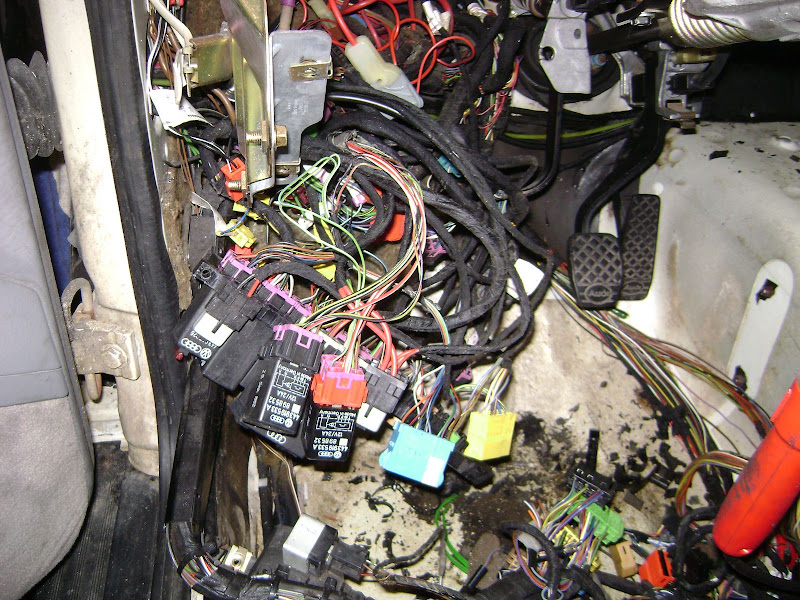

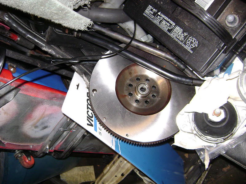

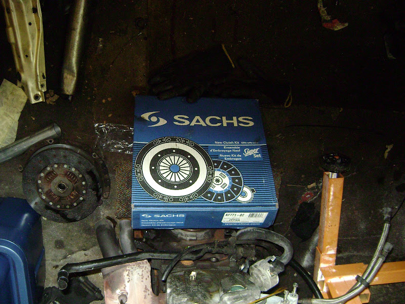

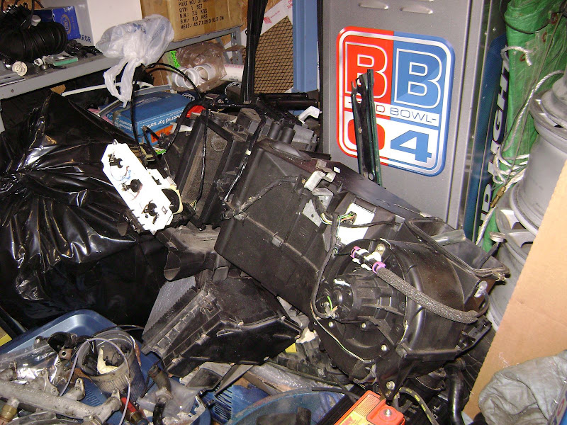

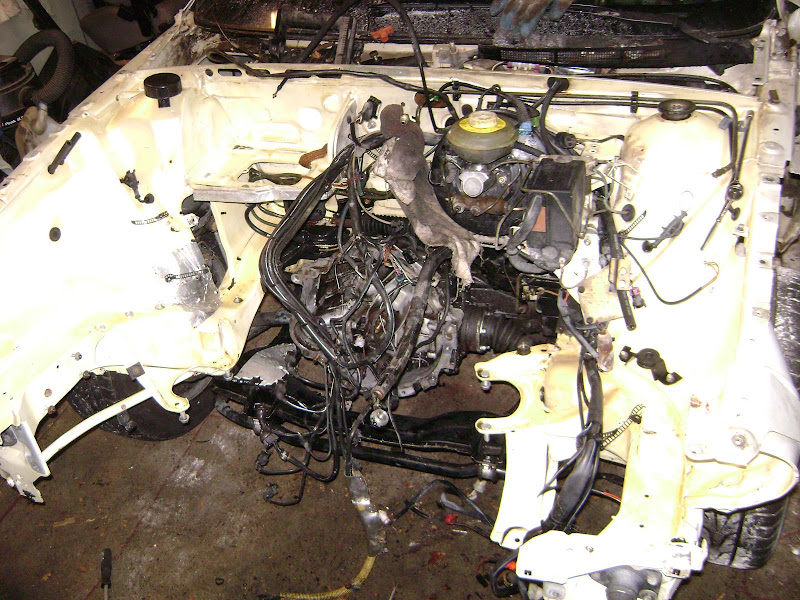

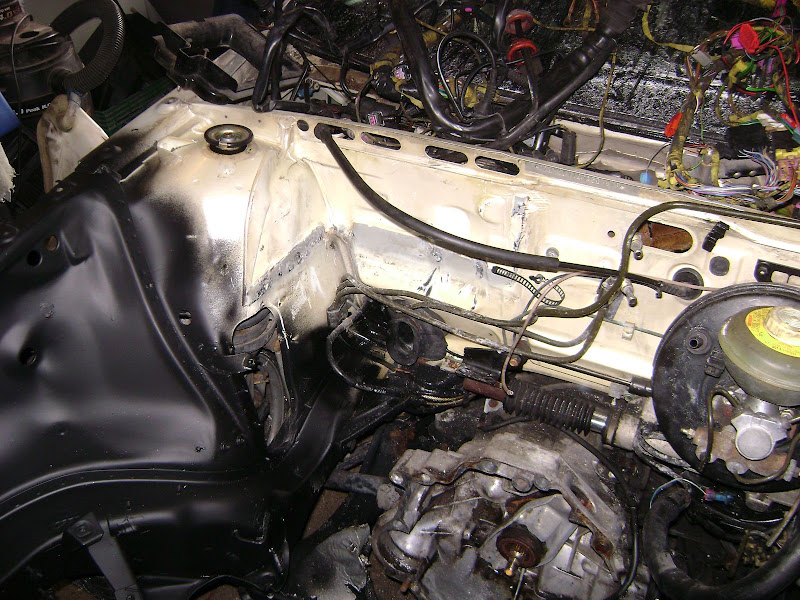

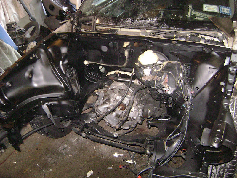

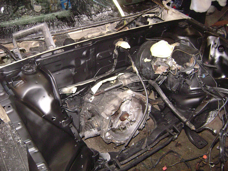

                    just a little update:
                    Engine bay nyce and clean
                    New Clutch
                    Re surfaced flywheel:
                    Painted valve cover:
                    engine back together:
                    Manual Heather Box:
                    The lovely Spagetti:
                    Tray is out:
                    And the painted Bay:
