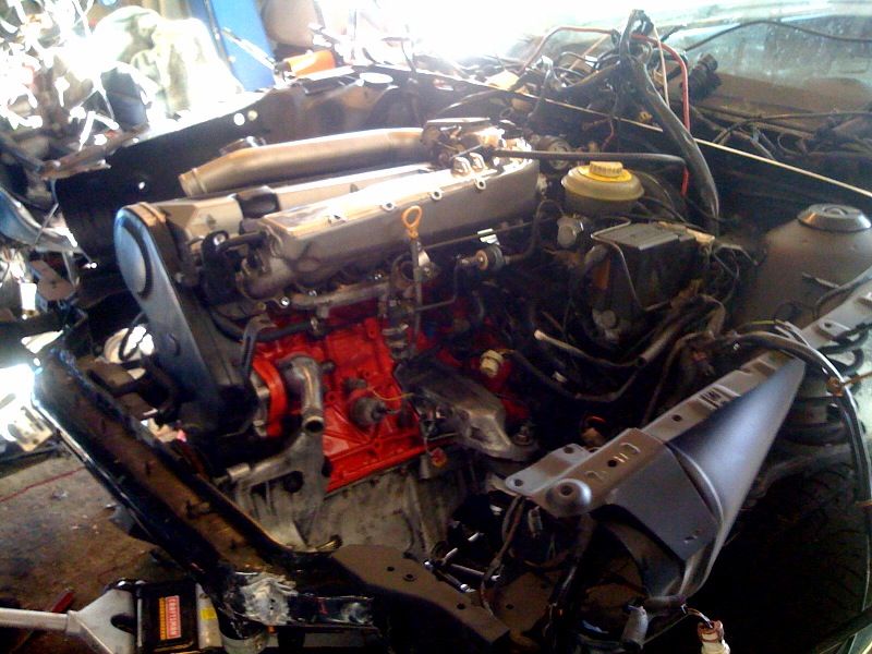

            little update.. MOTOR IS IN...
            yey

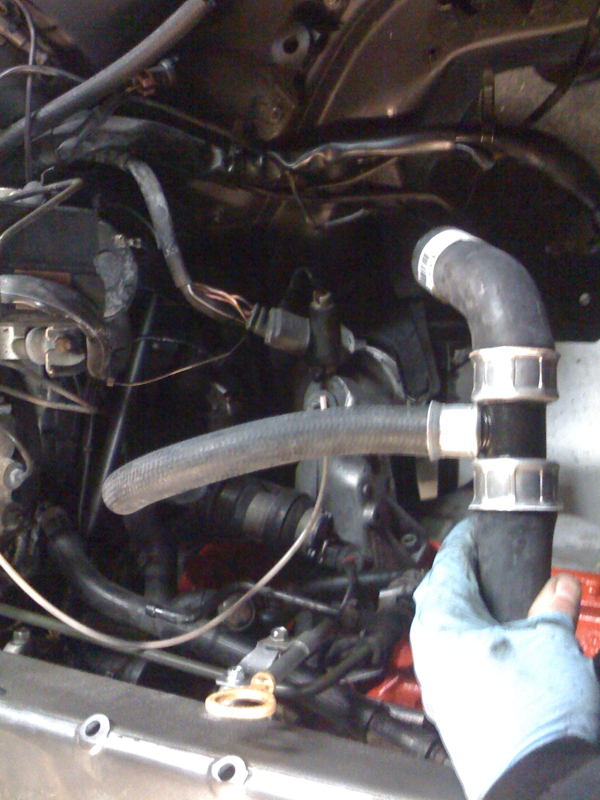

                          I still need to hook up a couple of Vacuum hoses and the after run pump.. Which i will me making a T fitting so i could cut my upper radiator hose and splice into that...

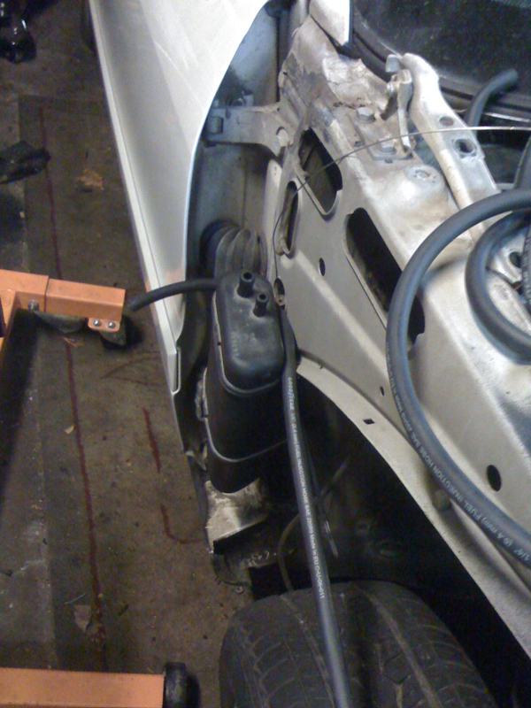

                          The EGR stuff still needs to be hooked up and i moved my Charcoal canister into the pass. side fender...

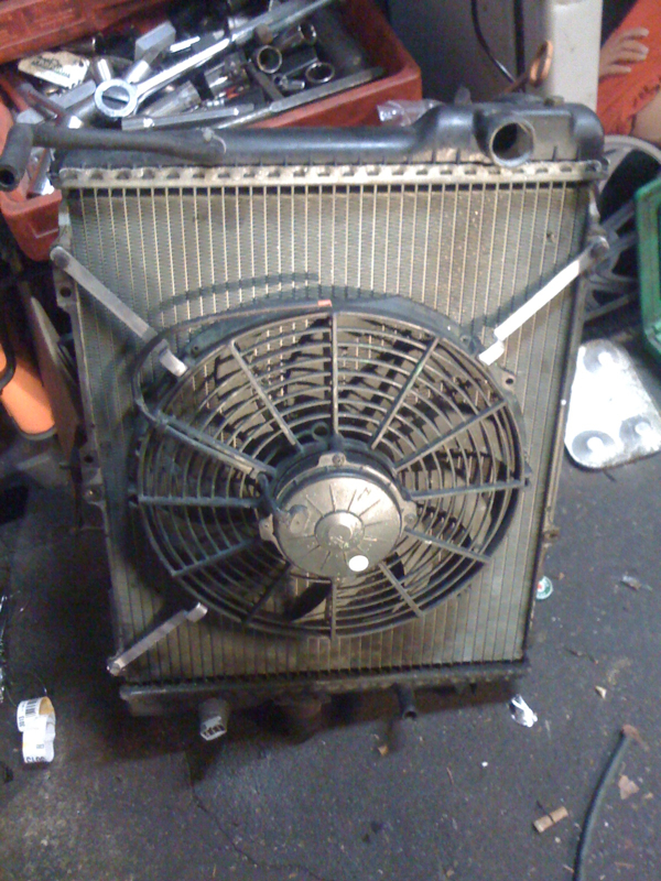

                          My best friend did some brackets for me because i removed the Big Old Radiator fan and replaced it with a Spal High Output fan...

                            That isn't EGR stuff connected to the carbon canister - it is part of 'EVAP' system to treat fuel vapours which can build up in the fuel tank in hot weather so that it can breathe.

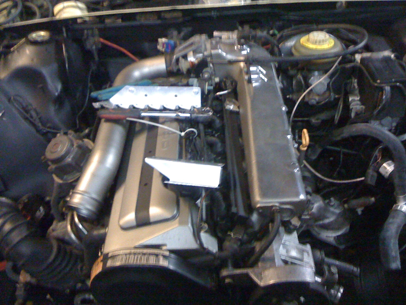

                                Well I got a little work the the engine is all back together and in the bay :
                                I had to make a pipe for the radiator to adapt the after run pump
                                I just found a hose at my local part store and just used the T fitting and made up the rest.. That picture just shows you the T fitting.. That actual hose didnt work..
                                The EVAP Canister in the fender:
                                I noticed that my original fan was starting to get burnt out so i installed a SPAL slim fan:

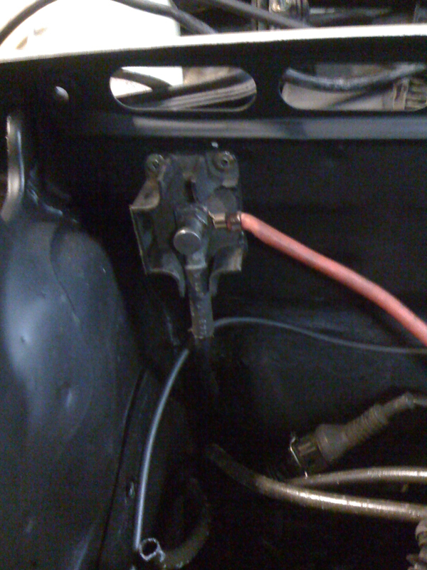

                                I also mounted a terminal in the front of the car just in case:
