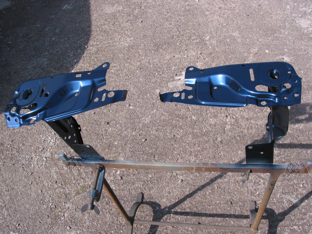

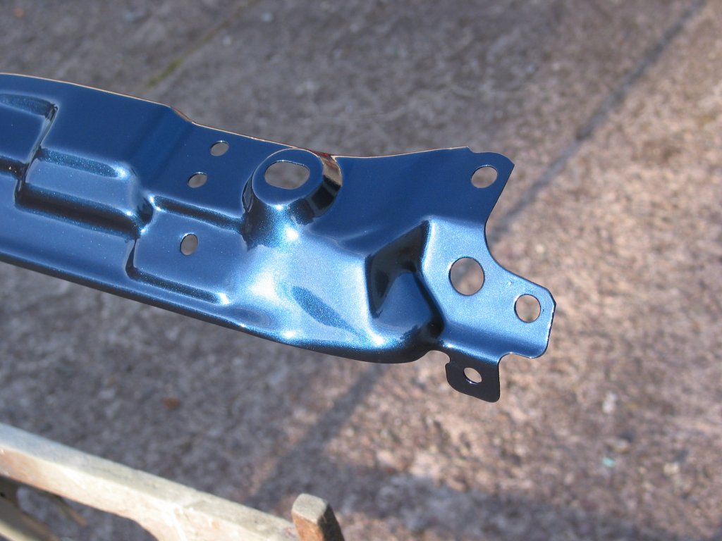

    I hope everyone had a good weekend, I took advantage of the one day of sunshine we got.
    So I have a little update. More odds and ends .

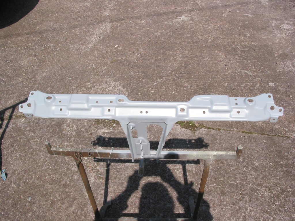

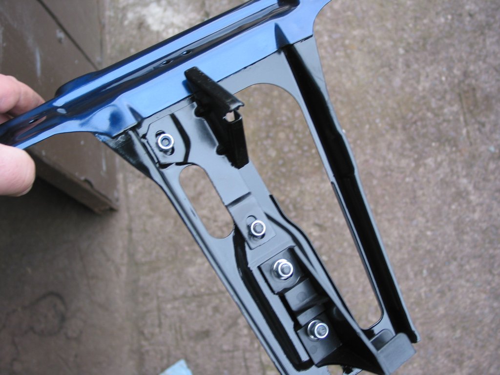

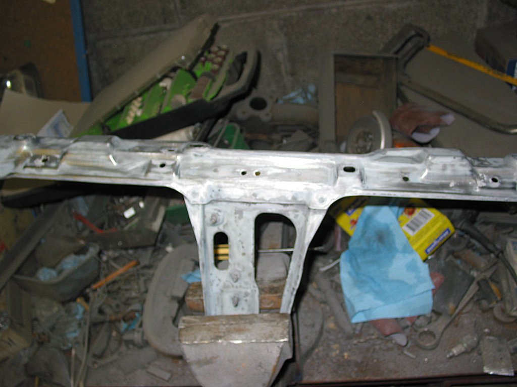

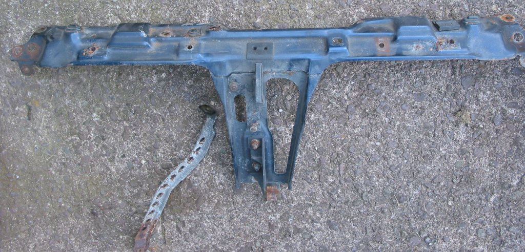

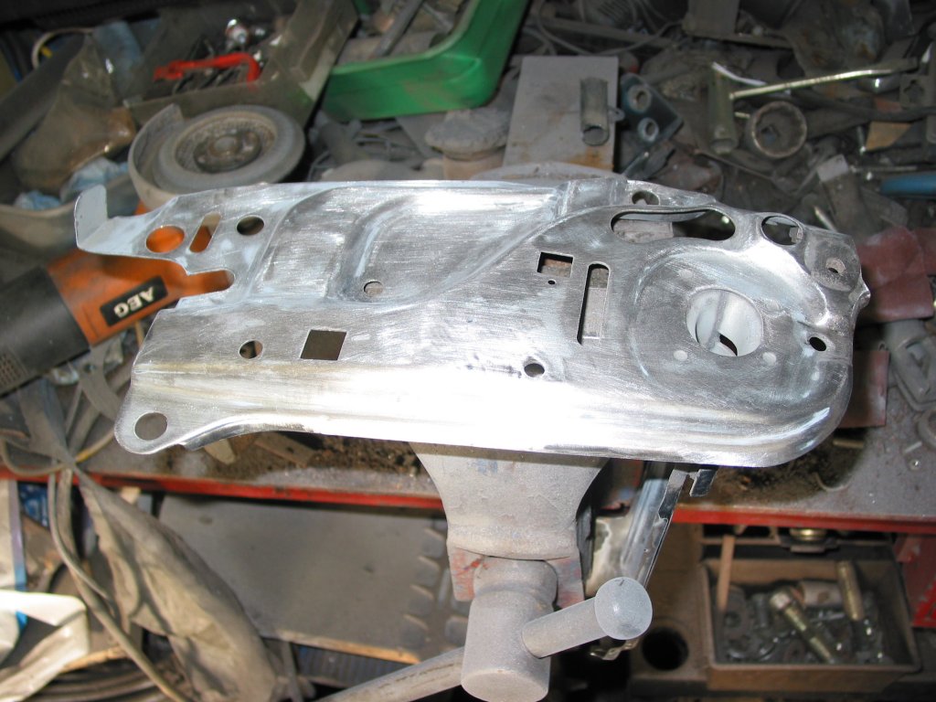

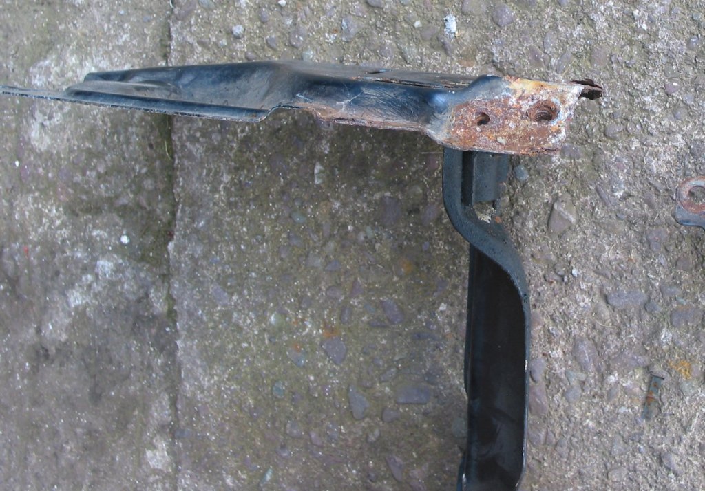

    My slam panels were very very rusty.
    All panels were taken back to bare metal.
    Almost back to bare metal. A lot of this was done in my tiny blasting cabinet.
    The panel was too large for the cabinet, but it was the only way I could get the scaley rust removed.

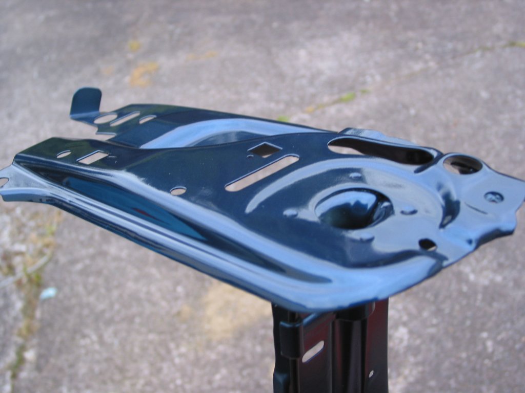

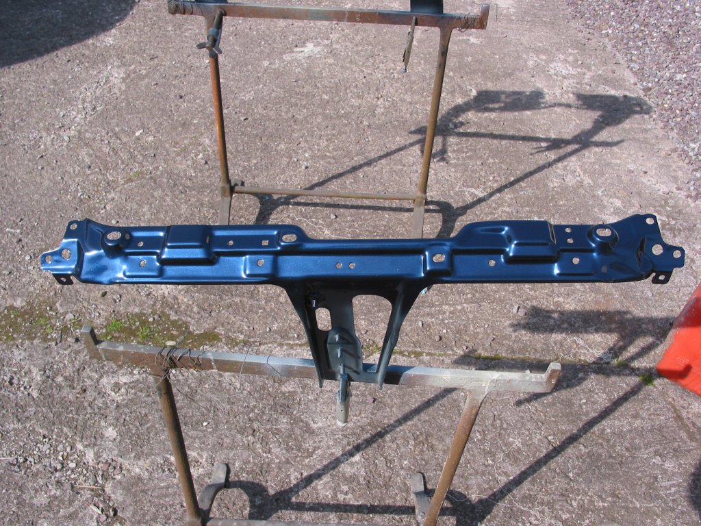

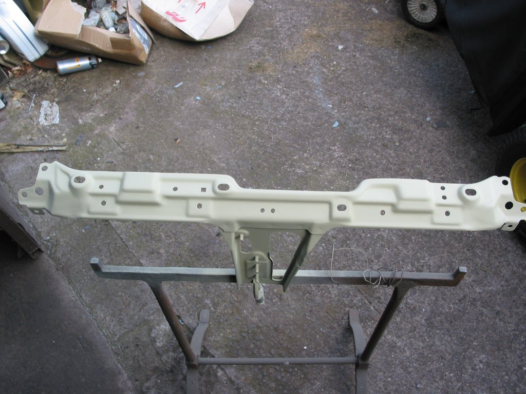

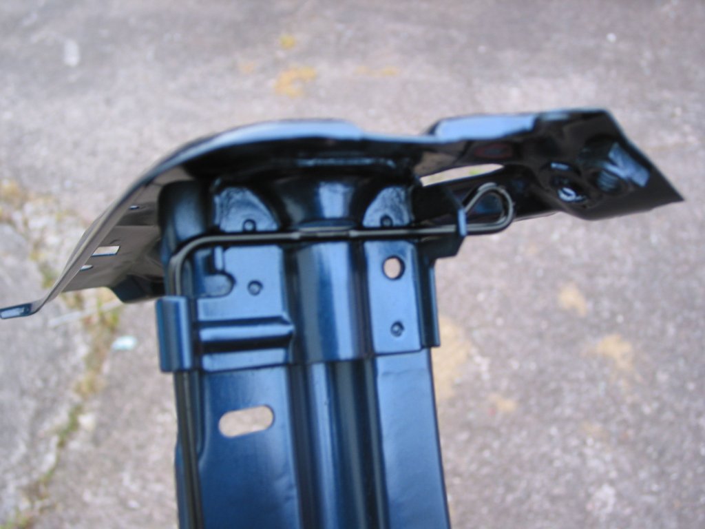

    High build primer
    Primer
    Base coat.
    Then a few coats of clear coat.

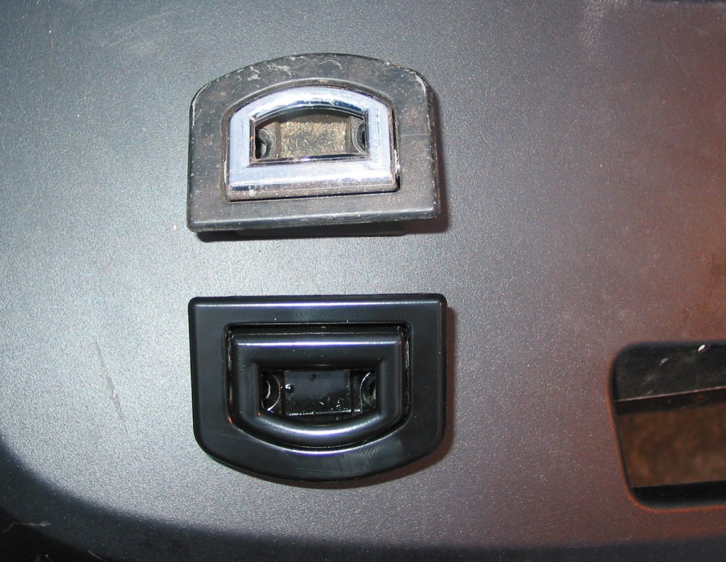

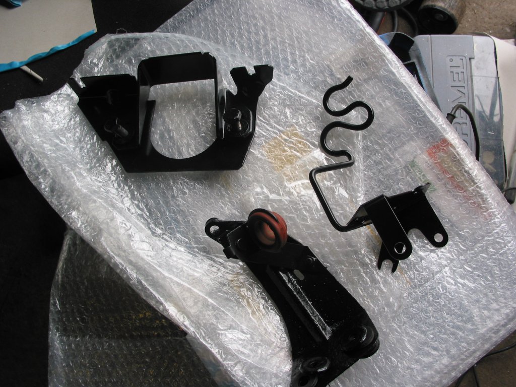

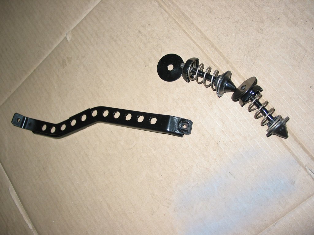

    Spring catch was removed and powder coated.

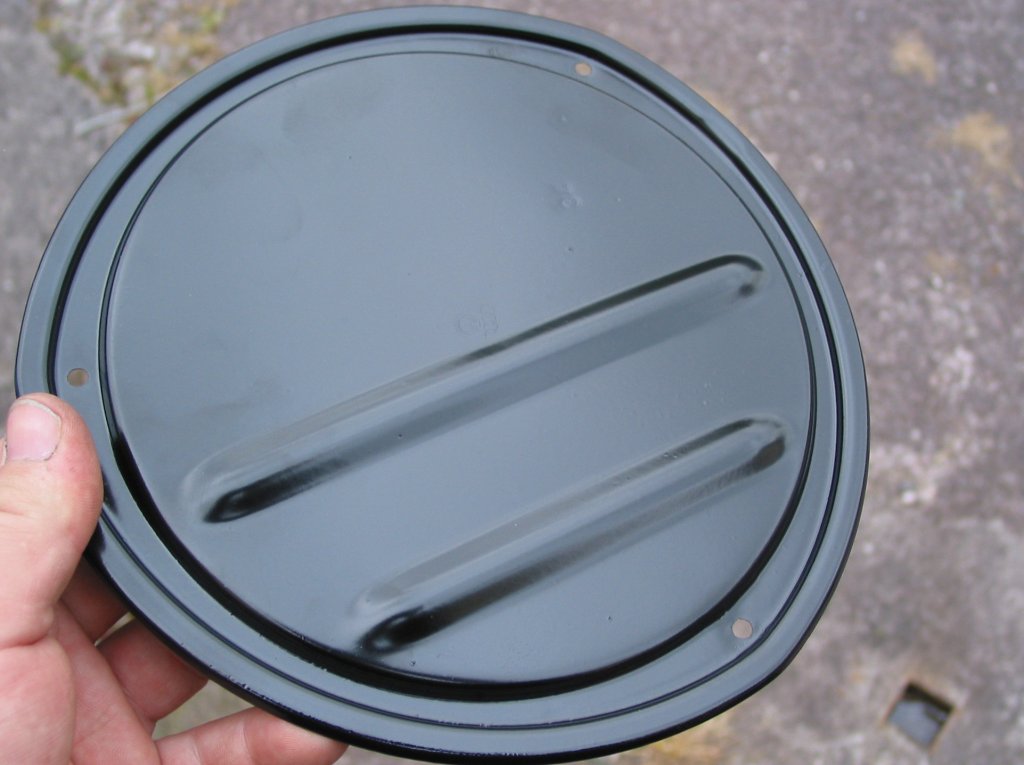

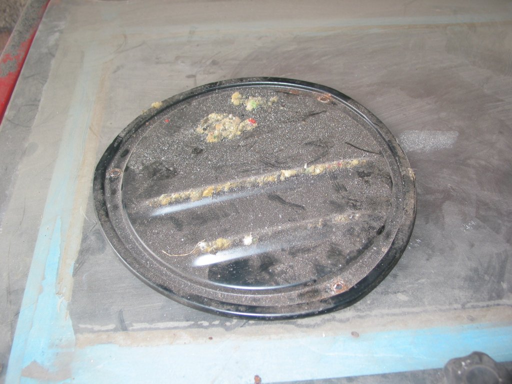

    Fuel pump access panel, was very grimy
    Blasted
    Coated.
    More stuff coated.

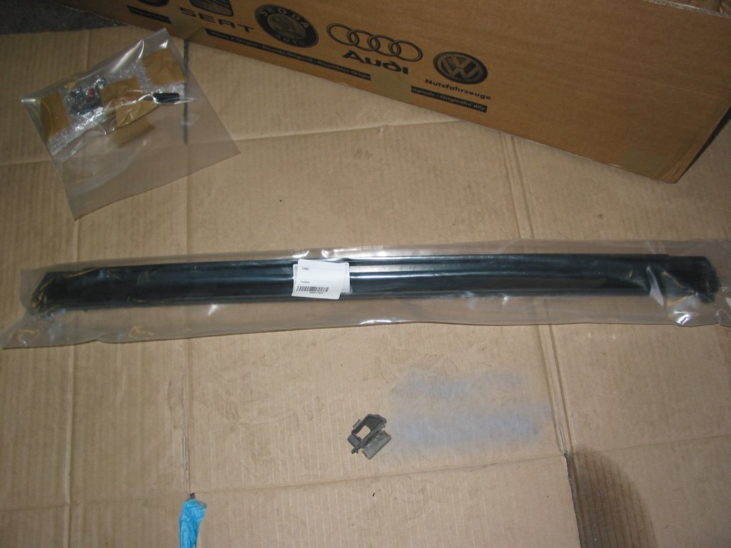

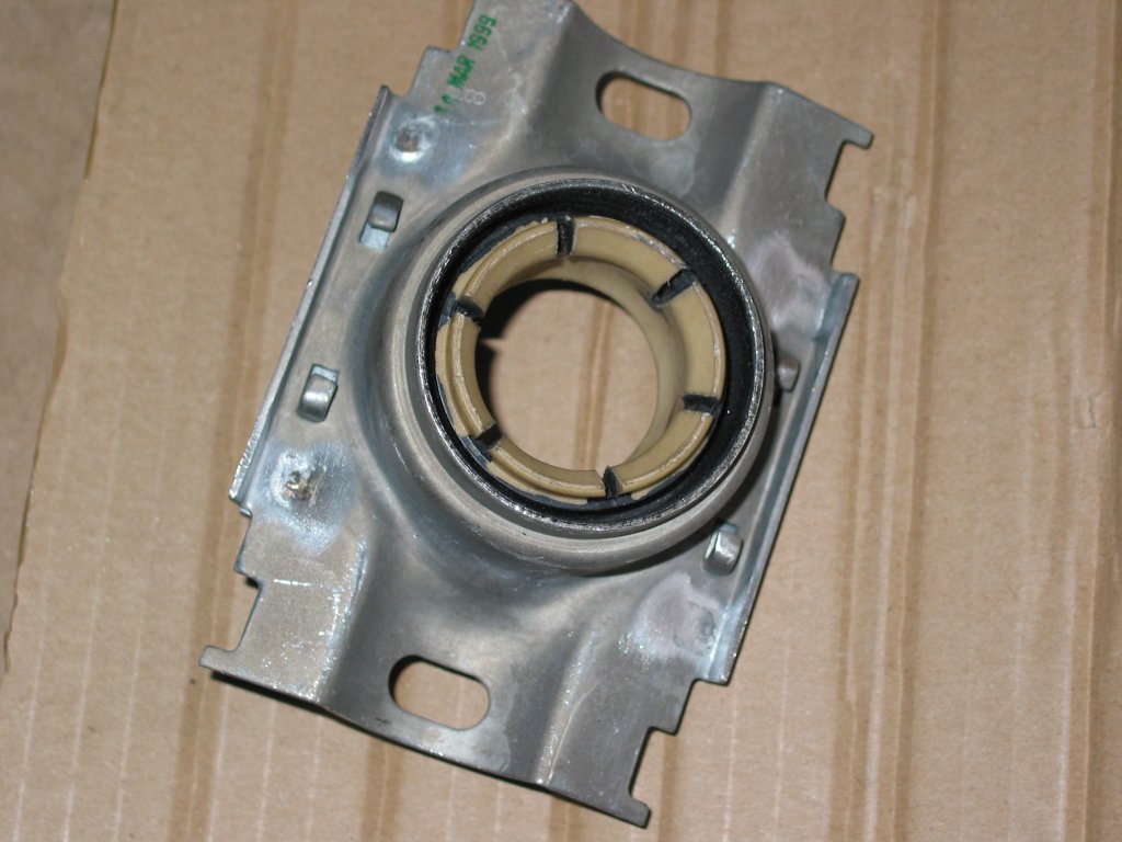

    Last week I went on a spending spree.
    The drip tray was missing from the sunroof panel. Luckly Audi Tradition had one.
    You can see the remains of my old drip tray below the new one.
    This part is gone NLA from the dealers. Its available from Audi Tradition.

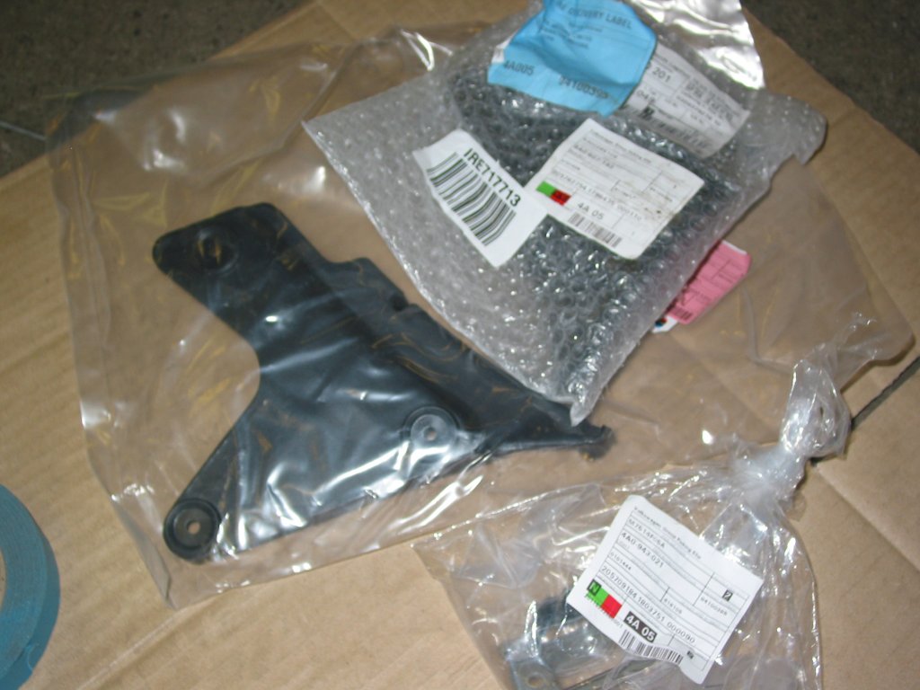

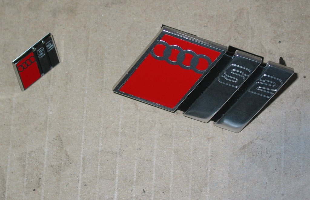

    I also picked up these at the same time.

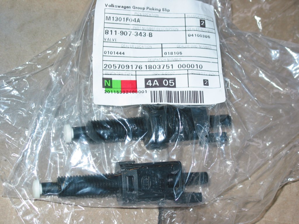

    I also took a trip to the nearby Audi Dealer.
    My cruise control during the test drive wasnt holding vacuum, got two of these.
    I also picked up some rear bumper brackets, these were cheaper that for what I have bought s/h ones.

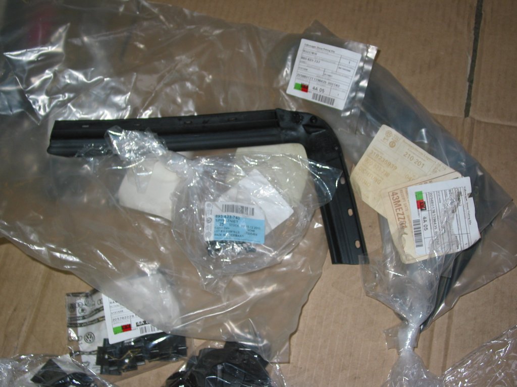

    The seal over the headlights ,that are attached to the bonnet. These are expensive

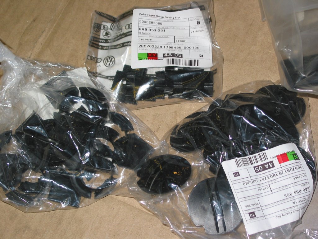

    Some various plastic bits. Sill clips and rear window c pillar cover clips
    So that's that. I am making a little progress on getting the car painted. More on that soon hopefully.

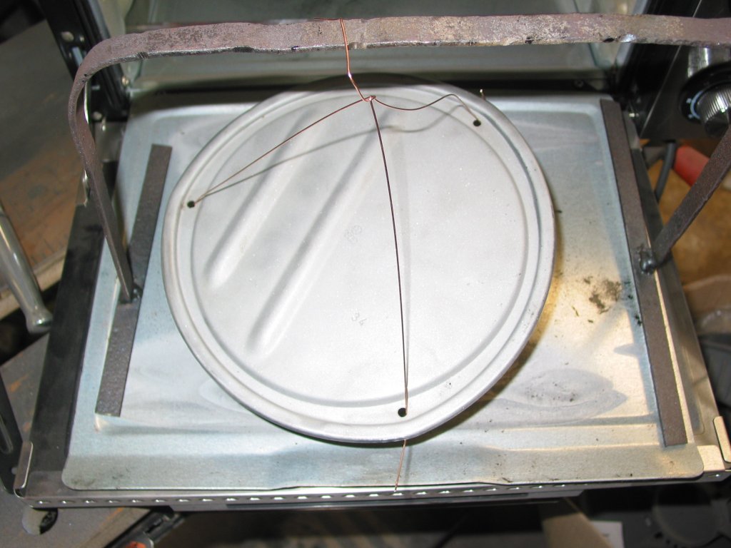

    Sample powder coat test worked out well. Looks like door pulls will look ok.
    Please excuse my greasy finger print on the refreshed part.
