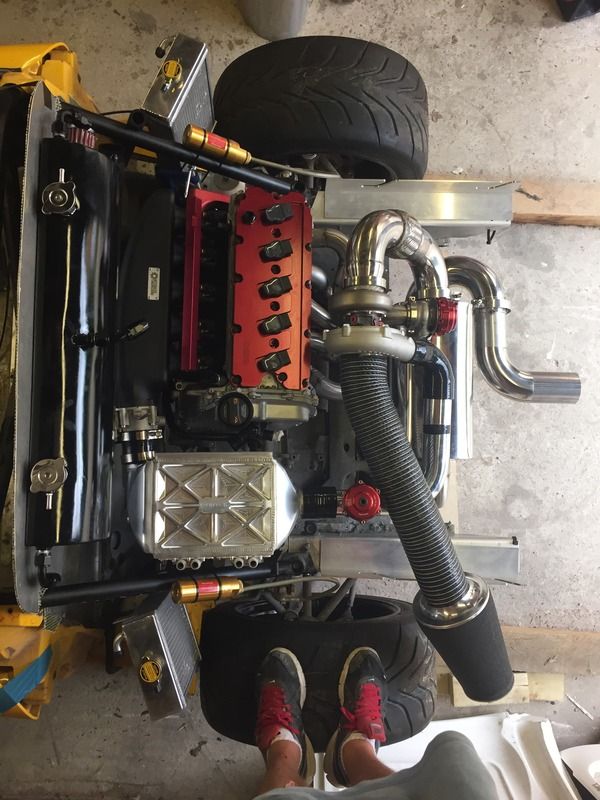

    Engine is back from JNL Racing. Massive thanks to JP for the swift turnaround and impeccable advice / engineering skills.
    I didn't hang about. Wanted to mockup everything. Glad I did as lots of puzzles to solve and plenty of plumbing to get on with before it all comes out again. It's going to be a busy engine bay that's for sure.
    It all fits.. just!!

          That is an understatement for a tight fit, well done
          • PRY4SNO
            • 767
            #80
            Gonna be a tight job doing oil filter changes, might be worth doing a remote filter housing?
            Bay looks the definition of tidy, well done!
                  Look closely at the oil filter housing
                    Nice trainers
                    Joking aside- looking at what you've done so far, this is gonna be the Doggies when it's finished

                      Thanks guys. Oil filter is easily accessible from gearbox side.. really great design by Issam..
