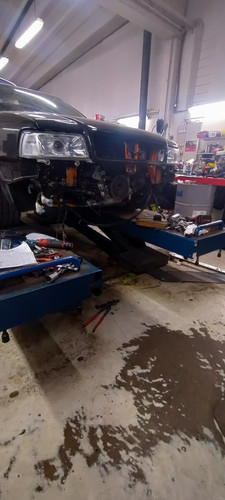

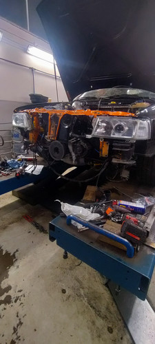

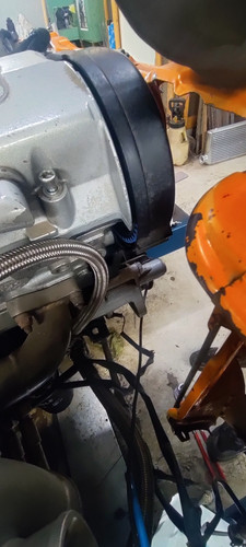

Still alive... alot of parts has been bought for the car mostly fuel related stuff ...
fuel rail ,FPR, fuel hardline,PTFE hoses, fuel pump, aluminium 3" pipes ,dump valve...
New handbrake cables also arrived from tradition
but have not really done anything, car still stands in the garage waiting for some love
