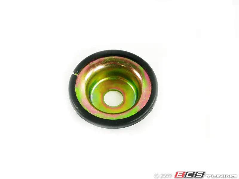

    I am looking for the round rubber/plastic dust washer from under the front top mount dust cover on my s2 . Are they dealer only or are they available
    I am not having much luck finding them .
    Do you mean the bump stops?
      No sorry I mean the washer that fits between the dust cap ant the top mount if that makes any sense
        Still confused. On coupe at back there is a round foam disc. Do you mean that?
          Okay, you mean the "strut stop" part number 811 412 319.
          I think these went NLA a long time back. I don't see them on Tradition or eBay.
          I think your best bet would be to post a wanted ad on here.
          edit: there are some available on eBay but they are way overpriced.

                  No 2 in the diagram is what I am looking for
                    What car is it for? Diagram looks unfamiliar
                      I have half a dozen of those if you mean the black plastic ring that goes on the outside of the upper sturt plate, which is what it looks like you're after.

                        I am sorry for any confusion over both the part and the diagram . My s2 is at a garage having the strut mounts replaced as I am unable to work on the car myself any longer . I am going to the garage personally to try and find out exactly what they need .
                        many thanks for your help and apologies once again
                          This part is what is required .a pair of ,not sure if they come separate or not . I just need the plastic ring.
                          This gallery has 1 photos.
                            The plastic ring aren't available as a separate part it's bonded to the strut stop, they all split over time. You don't really need them.
                            You can use a rubber washer that sits below the strut stop as an alternative to the ring.
                            You can also use the strut stop from a TT or Mk IV Golf i think it is, these have a rubber bonded ring and the "hat" of the stop is a bit taller that the original item but it works. I'll post the part number for these once I find it.
                            edit: take a look at this page below for some details:
                            https://www.oemvwshop.com/1j0412319c-stop-p248889/
