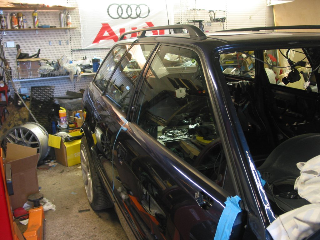

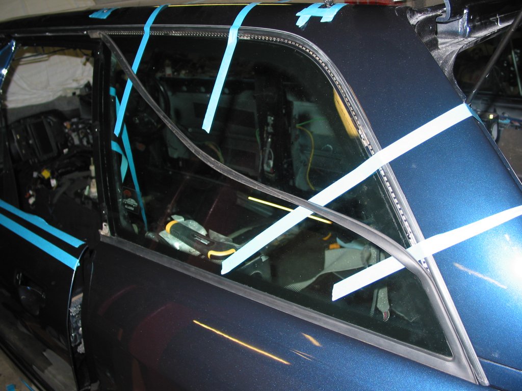

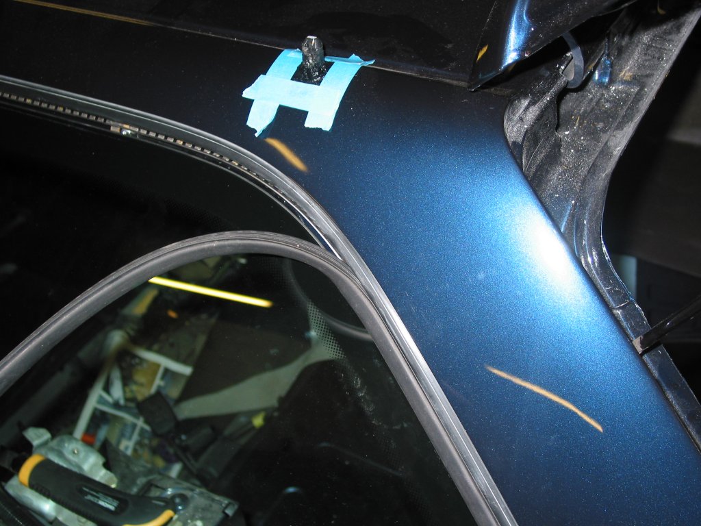

    While waiting for some bits to arrive to finish off the dash, I fitted the roof trim and I decided to tackle my nightmare, the rear windows. Ever since the first days of strip down I wasn't looking forward to doing these, but in the end it wasn't too bad.

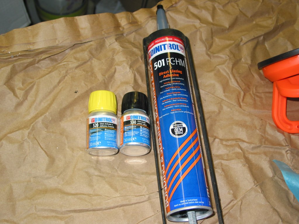

    I used this stuff, its polyurethane , primer and activator.

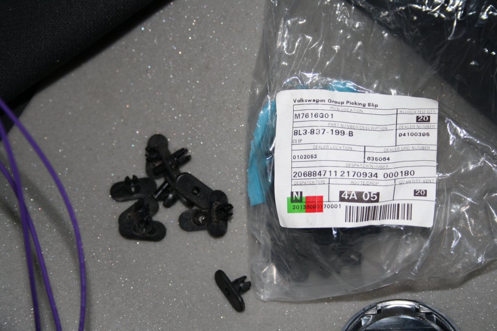

    I also needed 6 of these. They hold the window at the correct level and are clips for the cover.

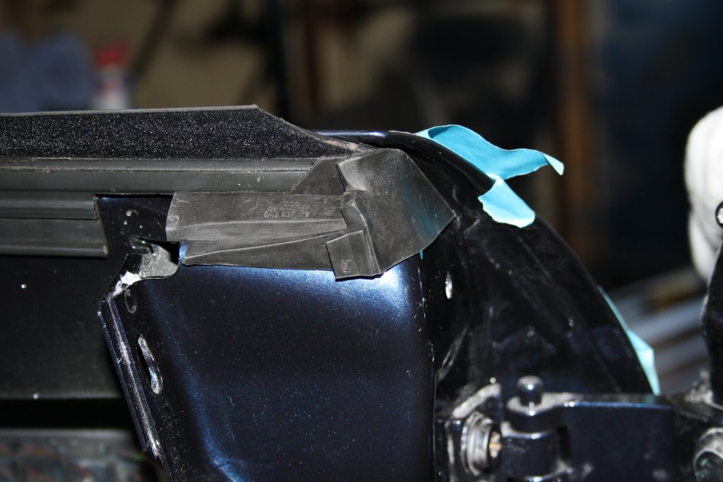

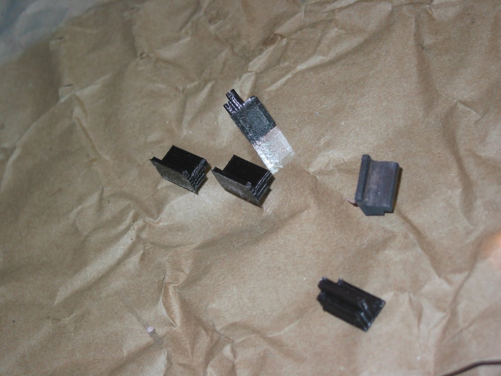

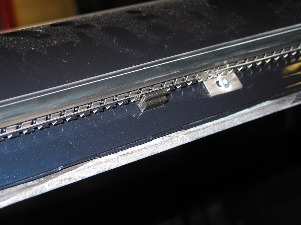

    In my opinion I also needed these. These are spacers that keep the glass the correct distance from the body, and the correct distance from the roof trim. There is no Audi part number for them, and I only had 1.
    So I 3d printed 4 copies and used those.

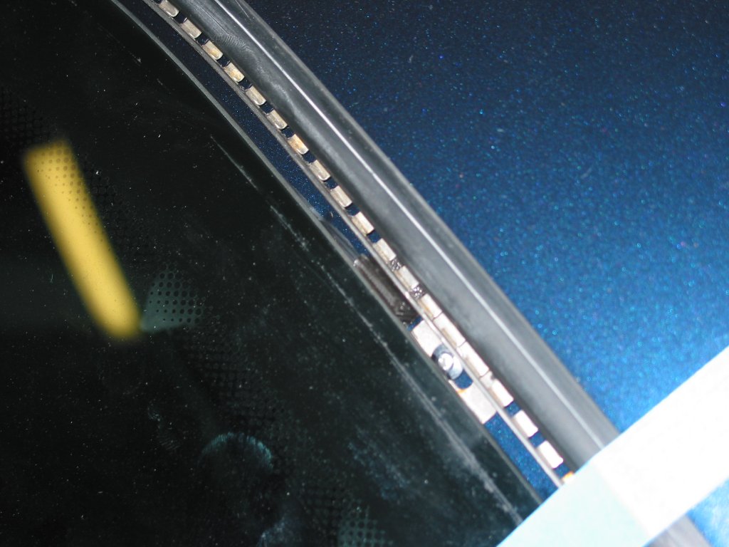

    After primer dried, the activator was applied to both the primer and the old trimmed adhesive.
    After that dried, I placed a pointed bead of adhesive along the old path of the adhesive.
    You cannot see it here but I had a protective apron over the wing when I applied the glass to the body.
    You can see the spacer doing its job here.
    After it cured I was able to refit the outer seal again.
    Done.

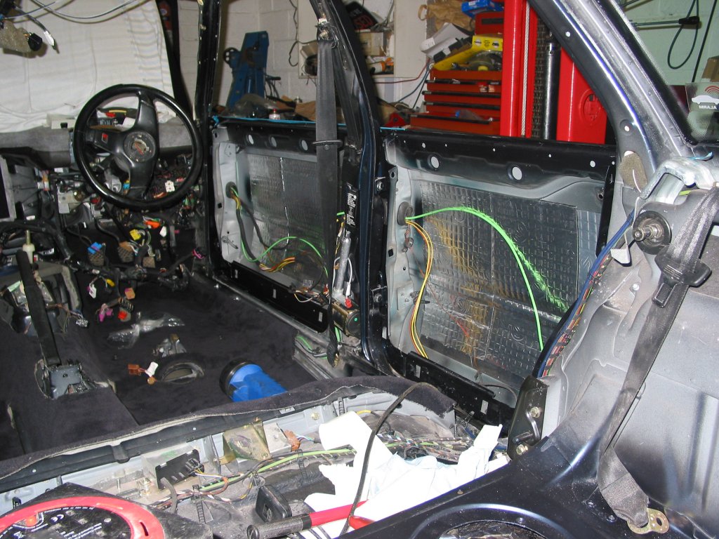

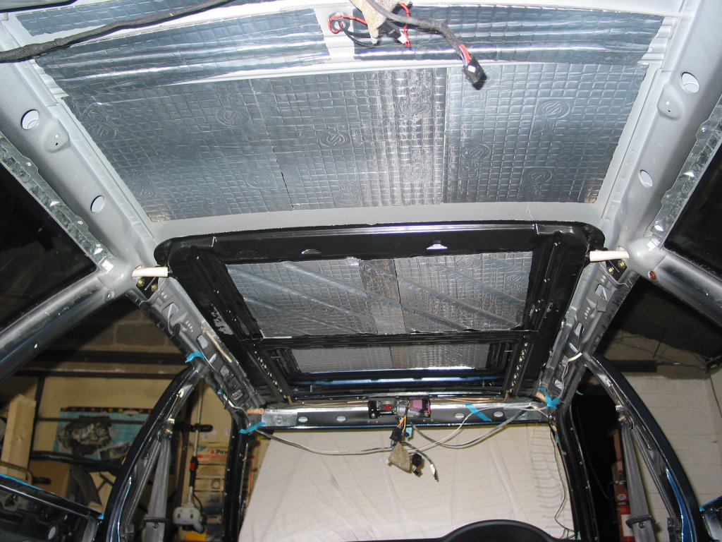

      More sound deadening
      For those of you wondering about weight, I removed about 2.3Kg of old deadening material from the boot section.(yep I collected it and weighted it)
      The new 4mm deadening material in the boot section alone comes to about 5kg .

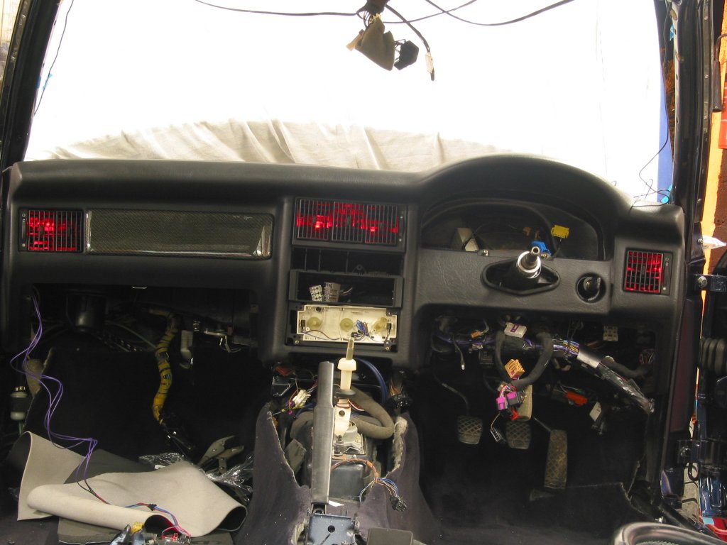

      I also managed to get the dash in and roughly aligned up. Got to route a few cables next. I also changed the wood trim for carbon fiber.

        Excellent work, have you got LEDs fitted in the event?
          #394
          It's coming together nicely. On mine I felt like getting the dash in was a real milestone.
          Where did you get the new antenna from mate? Mine is crap and despite the excellent tuner on the Becker it struggles to pick up much.
          Has someone graffitied your vents?

            Yep I have addressable rgb LEDs in the dash vents. As I was putting the dash together I thought i'd put these in.

                I thought that the headliner was a) enough sound deadening and b) glued (in spots) to the inner metal roof. How are you going to attach your headliner board to the sound deadening?

                    I have high temp 3m double sided adhesive tape that will stick to the aluminium of the material above.
                    Will find out very soon if it works.

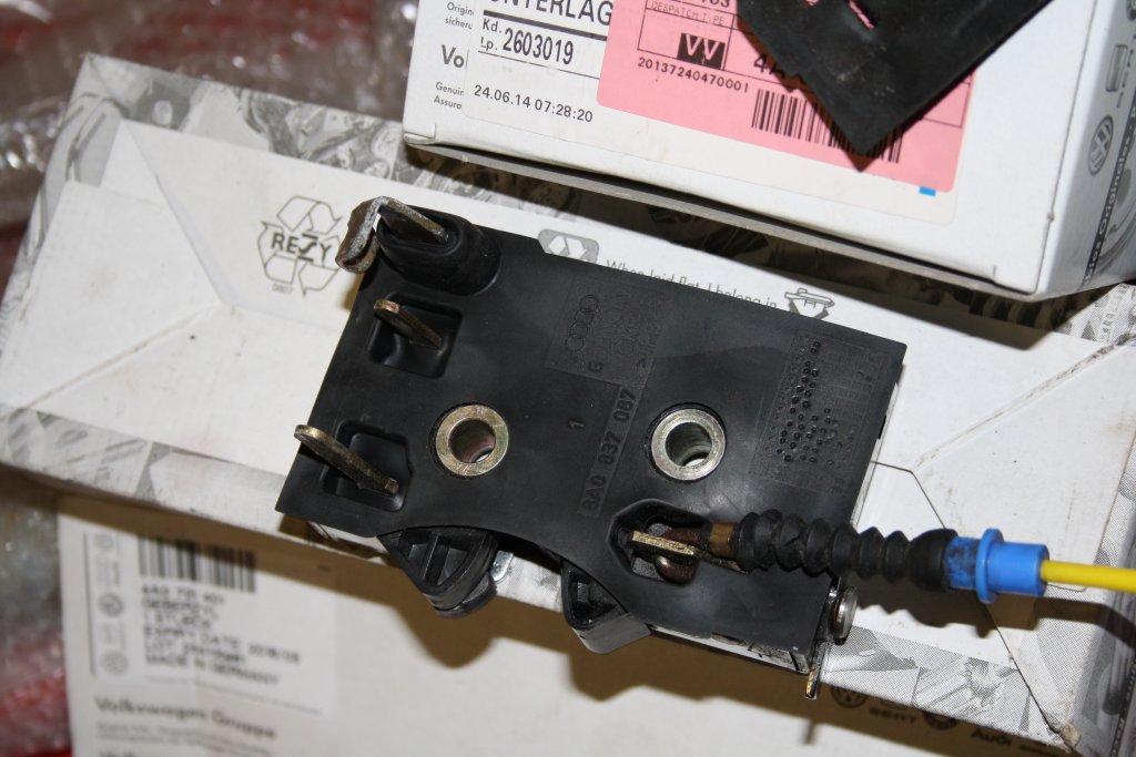

                            I blasted and plated the tailgate catches. I also put a new nylon insert into the lock catch.
                            The tailgate lock was siezed, and was the cause of my trouble oh so very long ago trying to get the tailgate open.
                            I eventually got it unlocked in my hand by tapping it with a mallet, then I was able to strip it down and clean each lock slider pin.

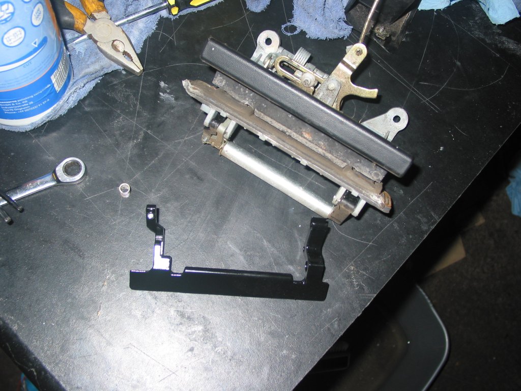

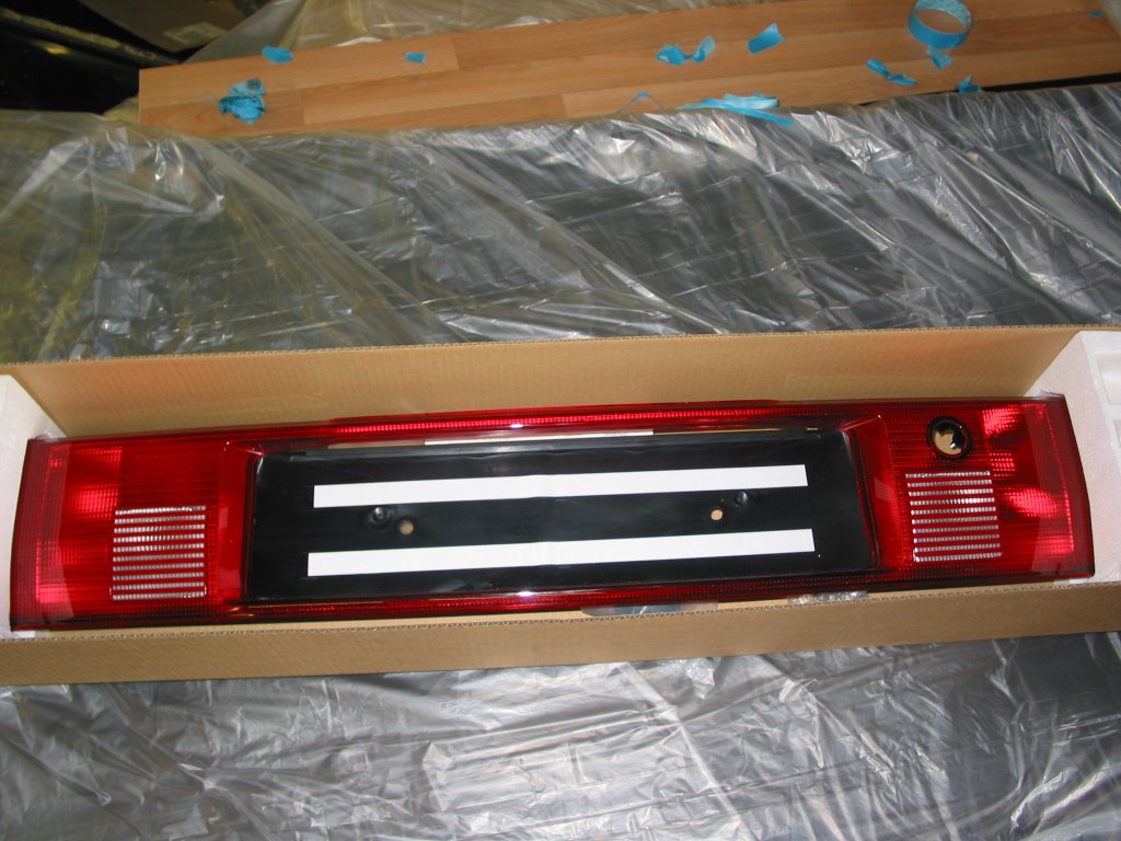

                            Managed to pick up a new B3 90 taillight section.
                            Of course fitting this required a modification to the release handle.
                            One cut and powercoated handle.
                            Removed the spring thanks to mcandmar's post on the topic.

                              Where did you get new nylon inserts?
                              '93 Audi UrS4 Avant
                              '15 Audi A7 quattro 3.0 TDI
                              • irishs2
                                • Apr 2009
                                • 2455
                                #405
                                *cough* UK ? lol
                                Thanks
                                I printed them in a cylinder shape , slit them on one side, and epoxied them on.
