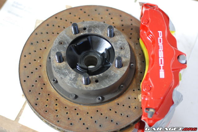

Is this the 2 piece you mean? Its from a 993 Turbo though...
965 is a onepiece disc.
With the 6-pot on the pic... had these discs with the bigreds...
Clean these disks up are reuse them, will at lease allow you to make the brackets

Yea i'm gooing mental haha...
My disc on the pic are to worn... falling apart

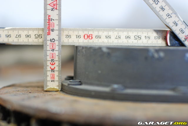

40mm from the hat is to little for me with my 18" cup reps.
Must go with the 993 351 045 10 as its the only one with 45mm from the hat?

The 965 discs are 45mm hat not 40mm hat, the 993 are 40mm hat.
http://www.porsche968uk.co.uk/techni...968-brakes.htm
this is why the 965 discs are direct replacements for the RS2 OEM 322 discs
When :corey: used to use the 993 disc he replaced the stock hat with a custom one to make it 45mmComment
