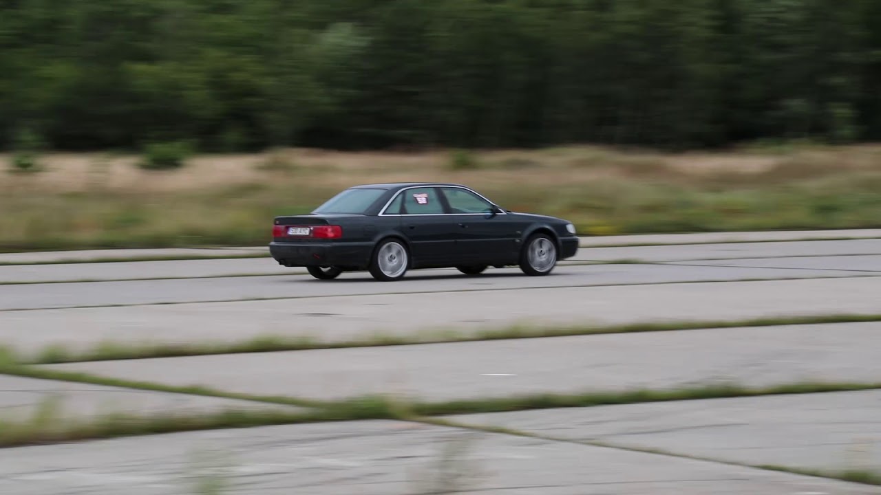

Tested car's abilities... I really need to change the gearbox.. I have diesel one... I put 5th gear at 250km/h... I have 6 gears
