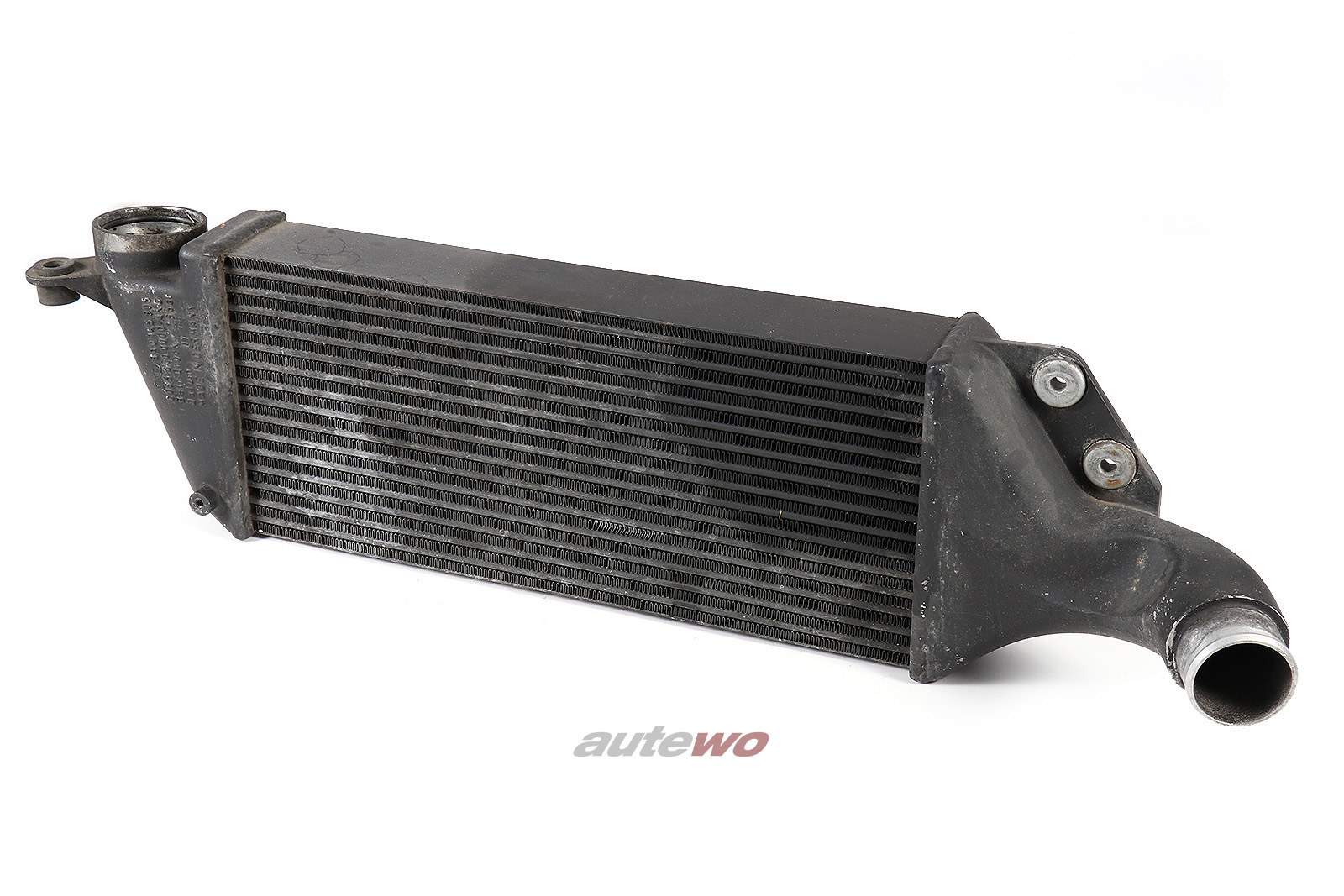

    Hey guys the plate on the front of the crank pulley has come away and hit my intercooler.
    Im in need of a new one or modified one asap.
    Also possibly a new or second hand intercooler for an aby. Or a modified one i dont mind.
    Any help or links would be appreciated, cars stuck here now.. ahhh!! Had travell far to do cambelt.

      expensive part :S but here maybe they have a intercooler to. https://www.autewo.de/034105251m-aud...ngungsdaempfer
        https://www.autewo.de/8a0145805b-aud...adeluftkuehler
