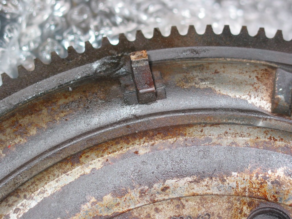

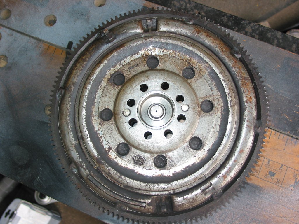

          G4 Timing pin:
          I didn't want to be wishing I did this, after breaking down at the side of the road sometime in the future, and after seeing a few threads here I decided it had to be done.
          My dual mass flywheel is in very good condition, no play at all.
          Here is the culprit of future problems.
          A quick blast of the wire brush , shows the pin is just held there with magic, and we all know magic wears out.

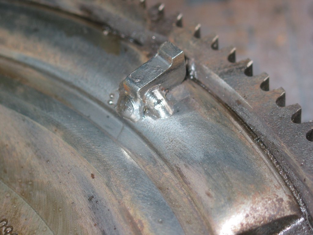

          I welded it with the MIG, high current, low wire speed and keeping the weld far from the outside edge so as not to interfere with the timing, and the weld as small as so its effect on balance is minimised. Hopefully.

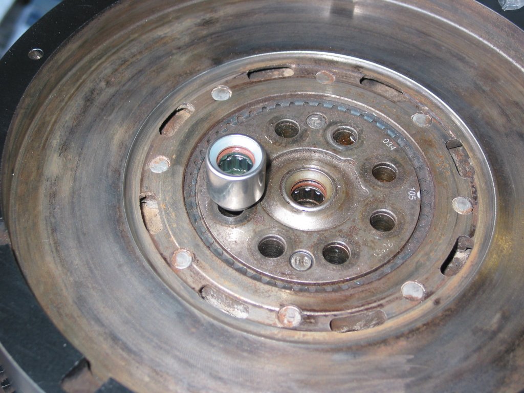

          I decided to do the spigot bearing too.
          I was surprised how easy it pushed out.
          New bearing in.

          • Very nice Eric
            I keep having nightmares that I welded my pin in the wrong place, luckily I got JP to balance my flywheel and pressure plate separately to the crank assembly so I have a get-out if need be
            I guess it can't be that vulnerable to very small inaccuracies as the block style pin on the DM flywheel is larger than the pressed cylindrical pin on the SM.
            I still don't really understand how the DM pin is secured to the flywheel,it must be resistance welded or something
                I hope so anyway.
                I think its resistance welded, and it would probably last lifetime of flywheel, but just didn't want to risk it since its been kicking around an enginebuilders workshop and my own for over a year

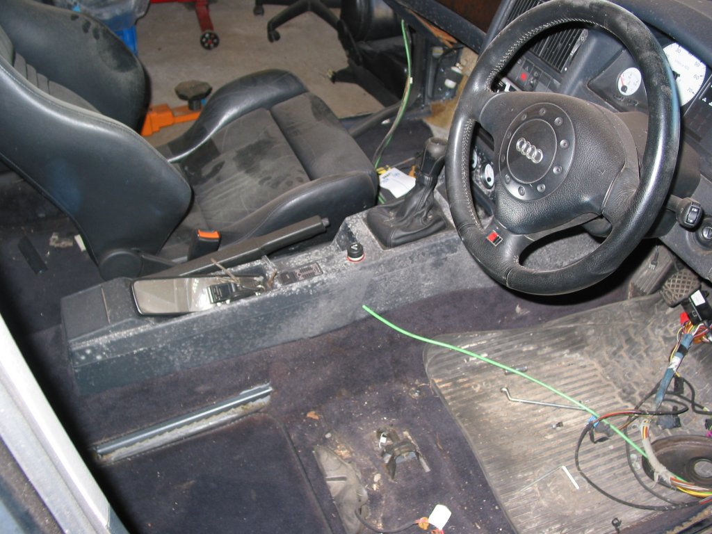

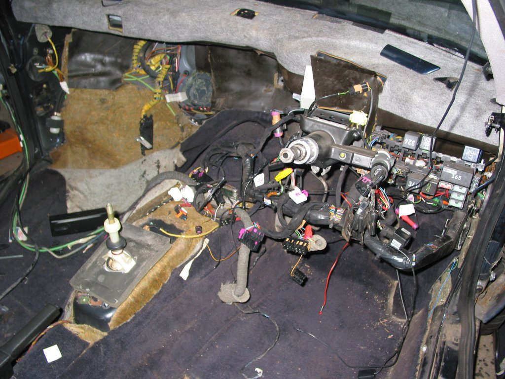

                To get that "New Car Smell", I have to do something about the interior.
                Everything has to come out, my carpet is in good condition but needs a clean, the underlay has to be replaced. The heater matrix also has to be replaced at this stage.
                I also want to go black headliner, and trim.
                Interior has gone moldy after being laid up for so long.
                Nearly forgot about these bolts holding onto the heater system
                All out, I want to remove the existing MPT1340 alarm and repair the damage to the loom. I intend to replace it with a TOAD alarm.
                Storage. On the top shelf you can see my recaros, and the makeshift shelf holding up the dash so it doesnt squish the leather of the seats.

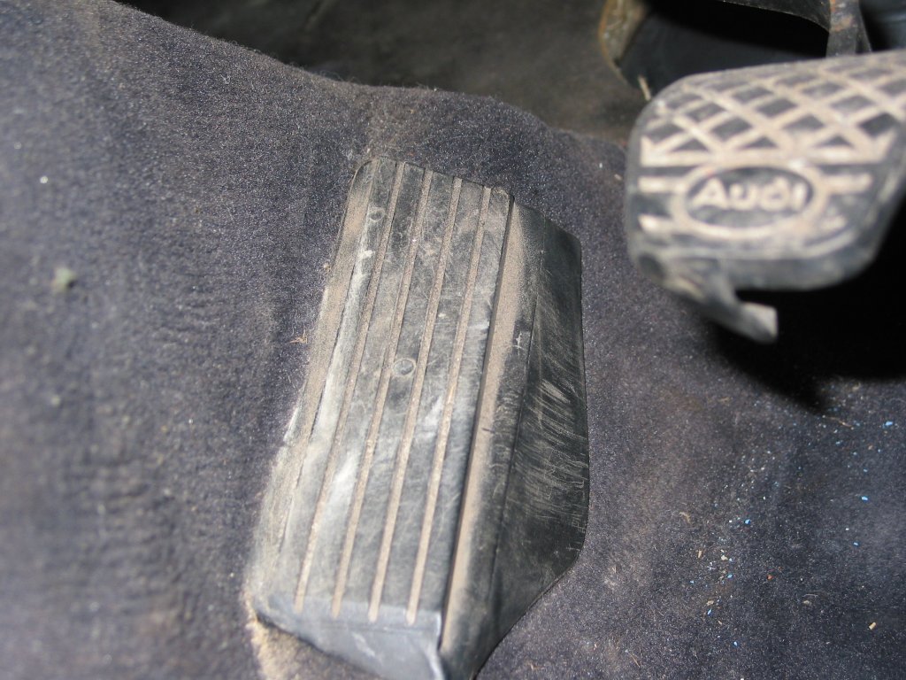

                How do I remove this?
                Eric
                95 S2 Avant under rebuild.
                • See the little 5mm circular pegs? Just tap them down and retrieve once you've lifted the foot rest trim and carpet.
                  • Excellent thanks.
