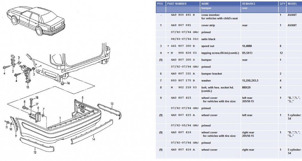

                    I could do with a small favour from someone:
                    If I open the boot (estate) and look down, there is a gap between the boot floor and the bumper, ie you can see the ground, I think it is missing some trim, rather than the bumper being bent, what is missing? Can someone take a photo? Not sure if I am missing a bit from inside the bumper rather than on top of it??
                    Audi S6
                      #100
                      Sounds like you might be missing Item 1 "cover strip" below:
