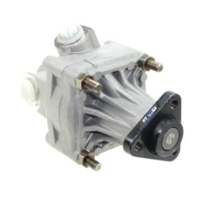

You have hydraulic steering & brake assist through a two stage hydraulic pump as standard on your 3B. If you move to a single stage pump like the MK4 one, you will need to swap the hydraulic brake servo for a vacuum servo for the brake assist. It's simpler and much cheaper to maintain than the hydro system, with a better pedal feel
The OEM single stage pump I'm referring to as fitted to the B4, C4 & early B5 is this one:
The later B5/MK4 pump will do the job just fine, requiring some work to mount it
The C4 serpentine belt system is really bulky and would block most of the airflow to the rad, if it would even fit at all.
The serpentine system like the one you posted above on that 4 banger looks like a nice neat and compact setup

Did the vaccuum servo conversion before and it was the end plan anyway as even on the 07K set up I will have to go with the single set up.Cool, 100bar is the same as the S2 pump.
This is the part that had me confused.I have only seen this pump style on B3/B4 never on a B5 (even the AEB's which to us were "early" used the KYB pump)
