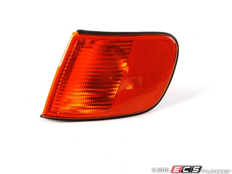

                    #519
                    Originally posted by hunker7
                    Thought so. No tinted indicators for me then :/
                    NAmerican C4 100/S4s got these. Lots of folks have changed them out for the "Euro" all silver ones. I'm sure I can find somebody with a pair to sell you.
                    • hunker7
                      • Mar 2014
                      • 3487
                      #520
                      These are dreadful
                      '93 Audi UrS4 Avant
                      '15 Audi A7 quattro 3.0 TDI
