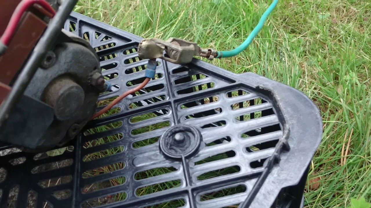

                    • I try it with engine off to bridge those 30 and 87 pins, but nothing...
                      Audi Coupe Quattro 2.3 20V
                      • Then there is probably your ABS problem. Dead return pump motor.
                        Working older ABS systems will do prrrrt sound and you can feel it through the brake pedal.
                        I'm not 100% but I think the abs ecu turns on the pump relay for a second to verify if the abs return pump works. If it does not in your case, then it will display abs light on dash.
                        1989 Audi 80 Quattro
                        • M2ki Is there any option how to be 100% sure? I buy some other used pump, but i want to be sure...I only hear ticking from the relais i think...No prrrrt at all can u record that sound?
                          • If your motor is dead, then there can't be any prrrt sound after the ignition
                            You can measure voltage between pin 87 and pump chassis, should be same as battery voltage.
                            • ****, its noisy No this noise is not coming from ABS pump at all Ok i check voltage
                              • That other prrrt sound after ignition, i'm not able to record that, its windy outside and its pretty quiet in the cabin. Only lasts lass than half a second.
