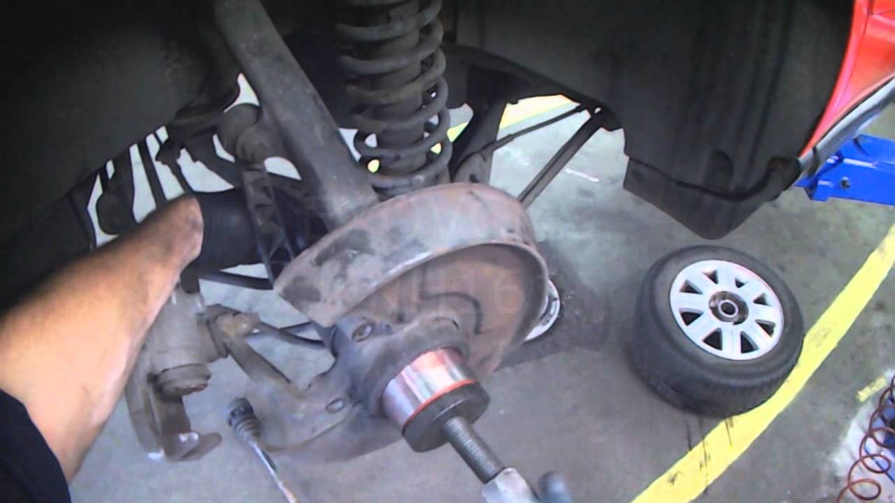

    Can I change the offending rear wheel bearing on the car or do I need to take the whole hub off again?

    • Depends what kind of tools do you have. It is possible to do it on the car.
