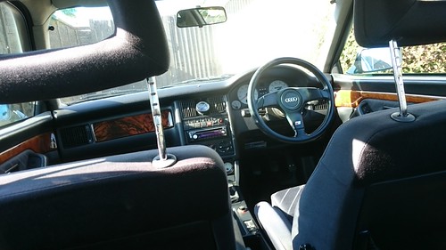

                I can’t believe how much time passes between updates.... however...
                I’ve gone ‘deep clean’ with the S2 today. As the old girl isn’t doing much I thought I’d take my time...
                So, I gutted it...
                Both front seats were wobbly as the nylon runners had failed because of the retaining clips.
                This image shows the hole where the retaining clips should be.
                So I used a push stud (and a blob of superglue) to replace the failed clip.
                And the finished interior without seats...
                After a full on vax, scrub and Meguiar's interior detailer.
                And with
                Today didn’t include the dog kennel boot which is another day in itself. Then there’s the bigger issue of the failing door cards and headlining....
                I suspect this could be a long haul ideally suited to where we are today....
