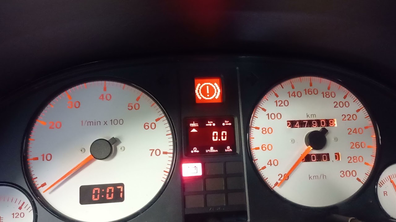

    Instrument cluster after rebuild of the trip-computer. Also installed new lights (led) for the instrumens, but i missed the digital clock, will fix that. The Auto-check is now also showing signs of life, the code 51 appears to come up if the knob for the (interior light/autocheck) is pushed in as the ignition is turned on. This make sence since my knob is stucked for some reason. I will dissasemble it some day and change to a spare one i have on my S2 instument cluster. Then hopefully the Auto-check also comes to life again

              Work is proceeding. Autocheck began to work correctly after i dissasembled the knob, wich was faulty mounted (stuck in pushed position). So now that works fine.
              Today i changed some light bulbs that were blown. With the help from past forum posts i changed light bulbs in the outside temp gauge and the diff lock switch. So now i mounted back the instrument cluster for the last time in a while i hope Been out and in a million times by now. Called the interior guy today, he has not started on my door cards yet. That was sad news, but no stress. I have some pics of some shining interior stuff anyway! Now i will continue with the window switches and rear mirror switch lights.
