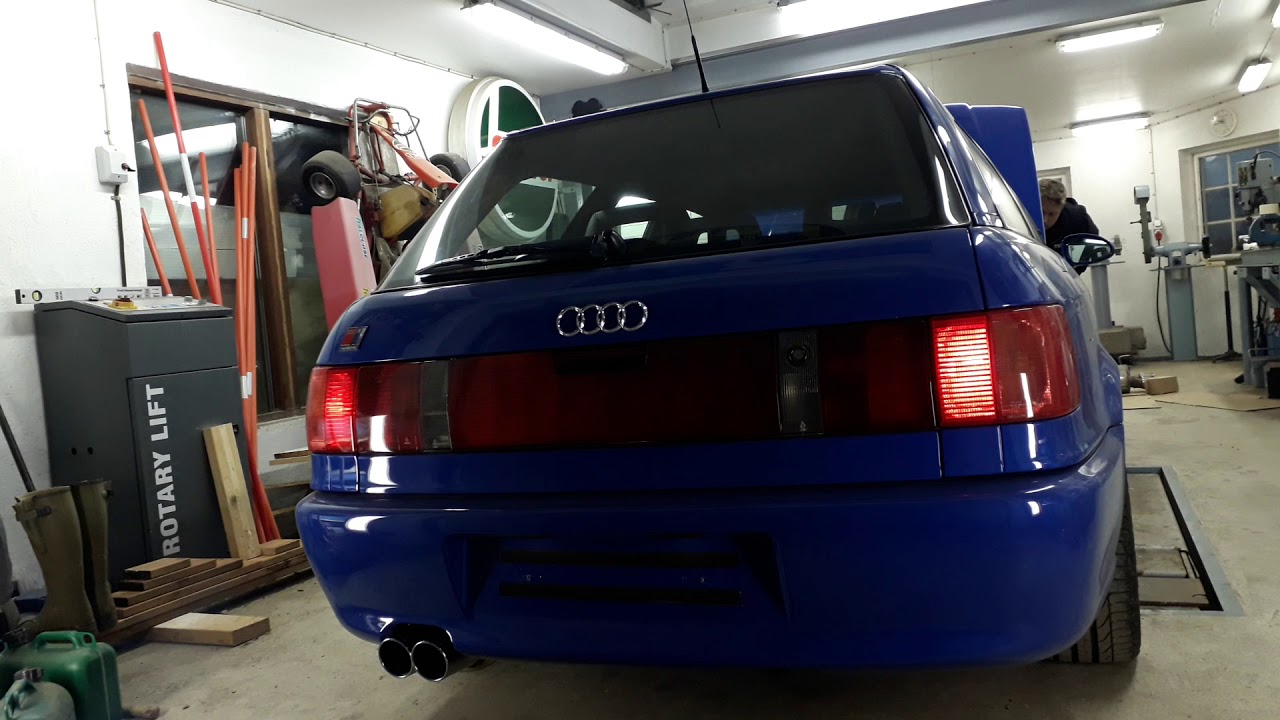

                      Good evening. Today was a fun day as my (hopfully) solution on my crappy exhaust arrived. Sure i could built my own with some effort, but that would be time consuming and at the moment i wan't to drive and have fun with the car. So what do you do? Searched the net for a complete exhaust and found that Super Sprint made complete exhaust systems for S2/RS2 Avant. Called the Swedish supplier and he told me that the system (Race pack, without Catalyst) was in stock at the factory in Italy. So i made an "investment" again.. Think this will be my birthday present to myself this year
                      The exhaust on the car was poorly made from both stainless and regular steel. The sound/resonance was terrible at most speeds/gears so i couldn't stand it at all. Sure i want it to sound but not in the coupé. I can live with some but not like with the system on the car.
                      Packed up the stuff (very well packed), looked at it for like 30 min and then i started to dissasemble the old crap. Mounting the new Super Sprint exhaust was no problem and the fitting is spot on. In the future/for next MOT i think i will dissasemble the exhaust and weld on a catalyst. Or maybe just shift back to the crappy exhaust. Last night i also ordered some new exhaust hangers from Audi TRS, but it works as it is now. Well here is some pictures of todays work, really happy. Now i will wait for some sunny days and go out on the road to test the new exhaust.
                      Package from Santa:
                      New exhaust unpackaged:
                      Old vs new exhaust:
                      Some shots of the system fitted on the car:
                      45764-af42e3dfa7e2739550d81bc5cc14dae0.jpg 45764-f9ead0d8998efbd7999e5f4955952a6e.jpg 45764-ea421b2295d97f20f73602f68b577157.jpg 45764-58f734a1ba04ecf8e0873b6125b93d24.jpg 45764-c3ac116bcf2f2b4e4d689c84c2c3b93d.jpg
                      And last some revs with the new exhaust:

                                Test drive of the new exhaust today! It's not quiet, think its almost louder than the old but with no disturbing resonance at cruising speed (Louder outside of the car). So i'm very happy with the exhaust system.
