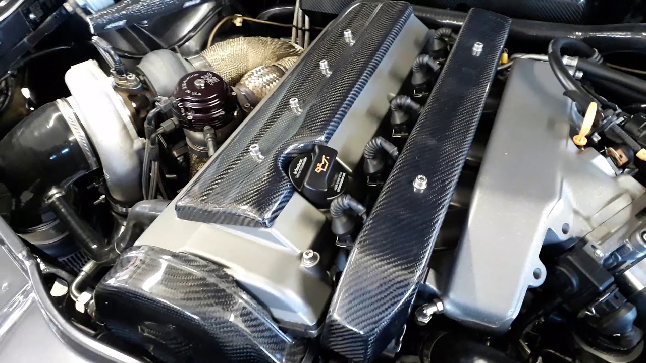

                      • To much at work and no strenght left to work on the car at night/weekends. But a few days ago i managed to drag myself to the garage to start put the car back together again. I re wrapped the exhaust manifold (I hate the time it takes, boring to) took like 1 and a half hour But then it was pretty straight forward without any problems. I managed to get the car ready for start up. But was to tired/ to late to start it up. But some day now i will start the car up, hopefully with a leak free turbo and leak free exhaustmanifold, i will be back with results
                        Wrapped exhaust manifold and refurbished turbo:
                        Start ready!

                              • Started the car about a week ago. Seems to be no problems yet. It's sitting och jack stands in the garage so no test drive was done. The roads are not that pretty either nowdays in Sweden. But i will find out pretty quick if the repairs are holding up. Other things that is going to happen is that i will connect the fuel pressure sensor to the Maxxecu, also i will put in the oil sump baffle i bought from Thuppu. Otherwise there is just to wait for better weather to do a testdrive..
                                A little video from the start up, it's the fuel injectors that are making noise, not the lifters if any body wonders.
