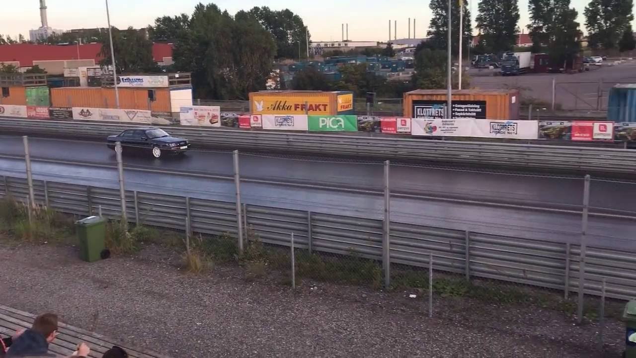

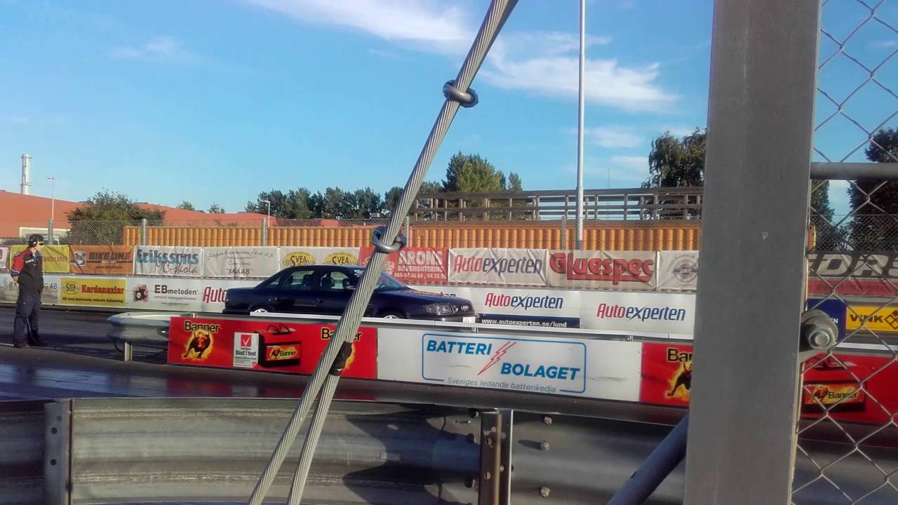

            • Going to the drag strip tomorrow. Testing some launch..
              • Sooooooo, how'd it go?
                _Rubí_
                • Originally posted by mushasho! View Post
                  Went good i think. First time ever for me at the dragstrip. Car was good. It's only 200m but it was fun,
                  Best time was 7.505sec and speed 154.27Km/h
                  Second fastest run but to much wheel spinn and to early shifting to second gear..
                  8.187sec and 151.17Km/h
                  I think i will try this some more, was quite fun
