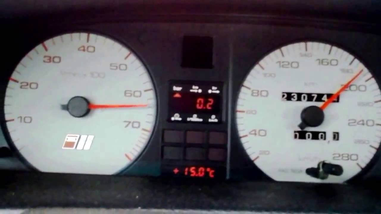

                        Today i was out and tested the car on the road. It sure feels quicker but it's hard to tell. Sure works fine any way. I will put the car on the dyno some time this summer for some fine tuning and to measure the power.
                        A little video recording from 2gear:
