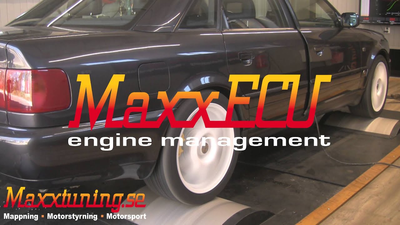

      After a 800km trip which started today at 3am i'am finally home. Everything went wery good. I thought i would get some more power out of it but i'am happy with how the car preformed anyway (my first build). No problems at all. I was told that if i pushed over 2bar it will may be a risk because i ran it on 98oct so i decided to stop at 2 bar. We tried to push it up to 2.3bar and i went good but i decided to play safe and vent down to 2 bar and 378whp (461hp at crank) was highest hp it ran. Unfortunately i forgot to record a video but the tuner recorded the dyno runs so he will upload it later on. Some pics of my day
      Power is measured on the wheels!

              Video
              A little video from the dyno

                      • So what was the limiting factor stopping you from making more power?...
                        _Rubí_
                        • Originally posted by mushasho! View Post
                          The tuner said that it was a gamble to push over 2 bar with gasoline. And the exhaust temp was going up to much. We went up to 2.3 bar but with no big difference in hp. The tuner blamed the fuel.
                          • I am not sure how you arrive at the 28% drivetrain loss (483 stated hp).
                            I usually tend to see 20% on these cars. And 378whp would be ~454hp in that case.
                            That said, on 98 RON this is a perfectly normal result. There is not much use going more than 1.9-2 bar on pump fuel. Result is only heat and detonation.
                            I don't know what the dyno's ramp rate was set at, but the spoolup seems a little late.
                            A HX35 Super makes the same power and has 2 bar at 3.9-4k.
                            WMI or E85 would help a lot. In fact I don't see why you don't use E85 with dual map switch if you are in Sweden, as E85 is almost more common than 98 RON over there.
                            • Originally posted by prj View Post
                              That was me writing wrong... The dyno sheet is "correct" . I don't know anything about their dyno ramp rate. what is that?
                              The reason i decided to go with gasoline was that i didn't have to build a new fuel system. Just dropped in a 044 and new filter, injectors. Maybe in the future i will change to E85 but for now it's going to run on 98 gasoline.
