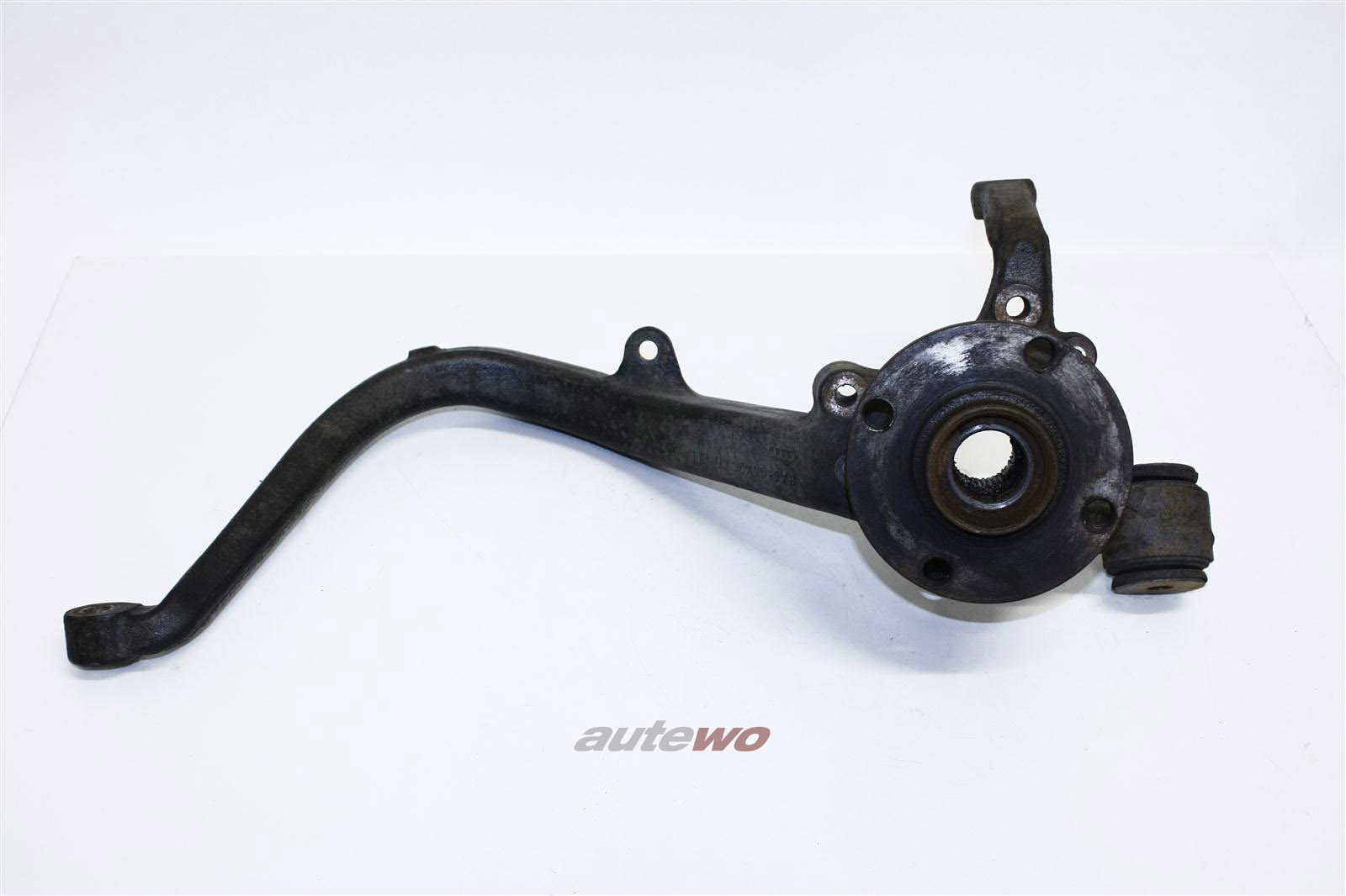

        Seems that the shaft itself was ok, but the outer joint was broken.

          75 or 82mm?
          1989 Audi 80 Quattro
          • Thuppu
            • 4115
            #320
            Hmm, I'm not sure. 33 teeth spline, propably 75mm if you mean bearing size..?
            • M2ki
              • Aug 2015
              • 547
              #321
              Bearing size yes. I thought that 2.8 came with 82mm bearings and 38 splines.
              • Thuppu
                • 4115
                #322
                Hmm, seems that saloon and avant has different part numbers. But then there is 4x108 and 5x112 hubs for both versions. So is there a 4x108 "big" hub available?
                • M2ki
                  • Aug 2015
                  • 547
                  #323
                  Yes there is 8A0501653C
                  • Thuppu
                    • 4115
                    #324
                    Ok, so this is from Avant, and has 38 tooth spline... Hmm..
                    • M2ki
                      • Aug 2015
                      • 547
                      #325
                      Just checked my parts pile and I have a pair of hubs and carriers from 2.6 avant and they are 82mm and 38 splines, so maybe it is avant thing.
                      • rxl
                        • 1913
                        #326
                        just go 5 stud
                        • M2ki
                          • Aug 2015
                          • 547
                          #327
                          Hubs are custom made?
                          Crazy expensive, in front he can use C4Q rears as he already has 82mm housings and in the rear use S2 82mm hubs and carriers, prices seems to be 200-300€ for a pair.

                            Rear driveshafts under b4 q chassis for 82mm housing are only available on S2/RS2 avant/sedan. Not even B5 S4 has them.
                            You have welded center/rear diff or everything is stock there?
                            1990 2.2 20VT Audi Coupe Quattro
                            *Hx35/k26, MaxxECU, Wagner EM/IC *RS2 Recaro *4pot-Brembo *3" turboback *Treser *Koni/H&R
                            1990 Audi 200 20v Avant 2.2 20VT *7 Seater *Full electric gizmos
                            • M2ki
                              • Aug 2015
                              • 547
                              #329
                              As I said before some V6 avants on B4 also have 82mm/38 spline hubs and carriers in the rear.
